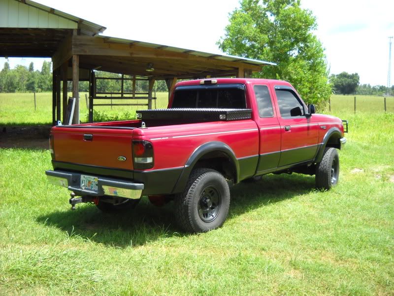

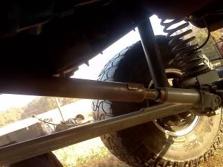

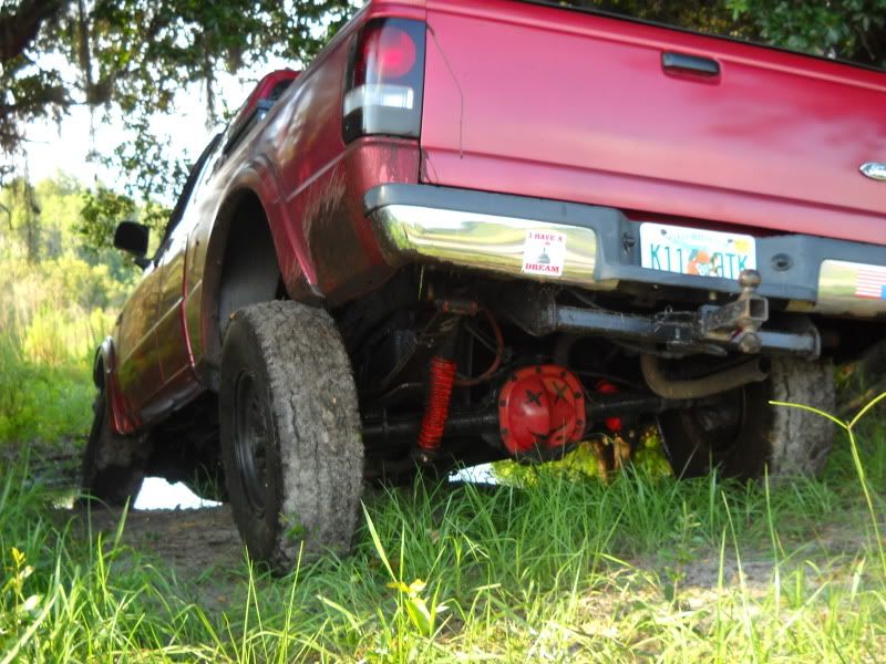

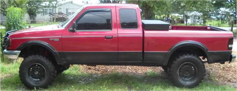

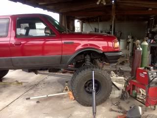

94 4.0 5spd 3.73 completley stock now has 4.0v6 5spd w the 4cyl gear mod. 77 fullwidth dana 44 hp spool 5.13s.94 fullwidth 8.8 detroit locker 5.13s. extended radius arms.custom coilbuckets.f250 shock mounts.rubicon express tj springs.rancho 9000xl adjustable shocks.rear 63 in chevy/dodge bastard pack.belltech shackles.1 ton chevy tie rods.drop pitman arm.36x15.50r15 mickey thompson atzs on 15x12 flat black mickey thompsons

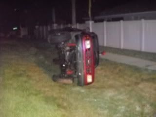

then this happened...

sold the lift and tires...bought some new parts...
