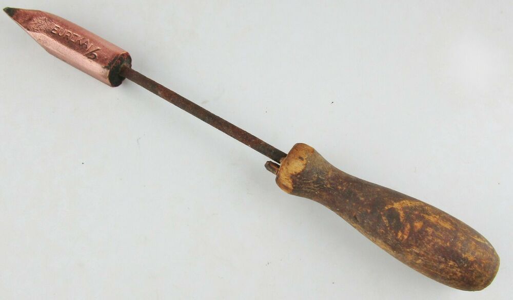

Years ago we used one of those to solder gas tanks. You'd move away from the tank and heat the iron with a torch so no flame was near the tank full of gas fumes. We didn't blow up so I guess we won.
