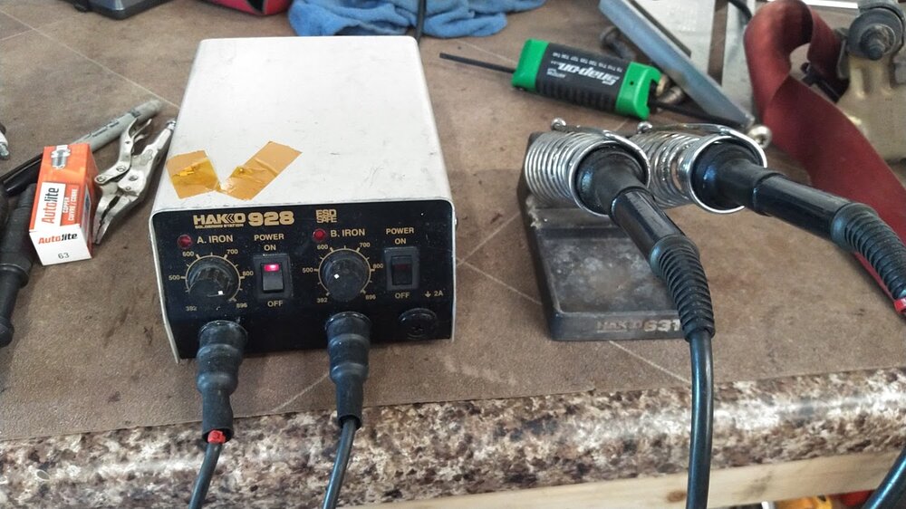

For electronics soldering I've got several, including some very cheap 5w pencils, a couple small Wellers, a much larger Weller pistol, and a Hakko dual iron soldering station. If you really need a soldering station, I'd check out Hakko and clones of Hakko - they are bitchin. Top notch quality that you'd expect from the Japanese.
