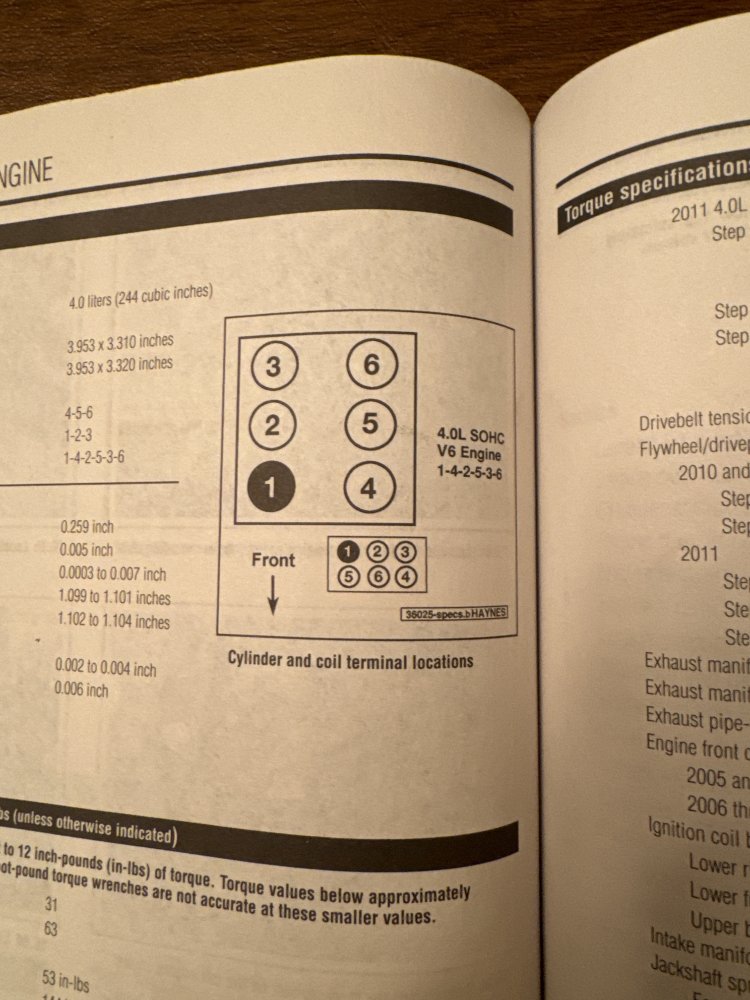

This is what I used to check, and I also replaced the wires one at a time. I’m not sure that is the issue. Are you saying the new coil pack is different?

I doubt the new coil pack would be different. As you can see in the image you pasted; the 4, 5, 6 are not in order, 5 and 6 are flipped. Since 1, 2, 3 are in order is it easy to think 4, 5, 6 is in order.
