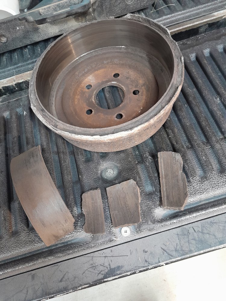

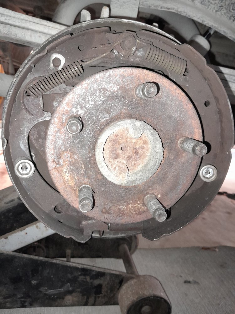

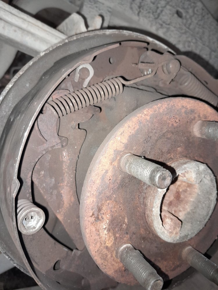

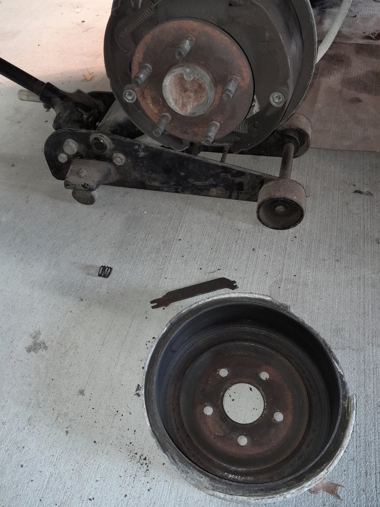

Been a couple of days, but finally had some time. Here's what I found:
I literally had no rear brakes. Pads on both sides were completely gone, except for the driver's side - they wee there but not attached to anything. The passenger side self-adjusting cable was corroded away.
So we have new drums but only one rebuilding kit available. Waiting for the other one to show up.
I think this would explain the soft pedal -- ya think?
Surprisingly it only started getting soft a couple of weeks ago. I don't drive it that much, so I didn't really think about it.
In the first post I mentioned that the brakes had been serviced in 2010 at 212,000 miles and it had been sitting since 2011. I've put about 4,000 and change on it since 2017. The receipt says they installed rear shoes, resurfaced drums, replace rear cylinders, spring kits, brake lines.
I'm thinking they cut a few corners.
Good thing you knocked them apart.
Hard to tell by the pictures... but something doesn't look right with assembly of the return springs... cable and anchor pin plate in the last picture. It also looks like the park brake lever is pulled away from the shoe too far for the "at rest" position. Might have a parking brake cable frozen up.
Your eyes are good...
I checked the ebrake on the passenger side rear and it is indeed frozen. I had a hard time getting the shoe in the correct position. Found that the ebrake cable wouldn't release. I disconnected it at the bottom and everything is fitting nicely now.

It looks like there are two spring ends wrapped over the anchor pin from the left return spring?? What the hell is that?
