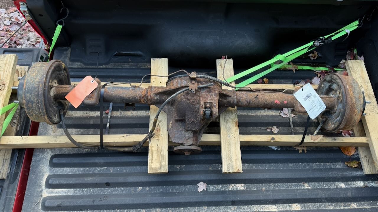

This is my point: the folks that say "just go get a whole axle with the right code" are doing the community a disservice and I would wager they either haven't actually tried to do so lately or got incredibly lucky. Good limited slip axels for Rangers just aren't common anymore assuming they ever were. Times change but I cant go to pul a part a snag up a bunch of Bumpside or Dentside parts like I could 15 years ago either. There were precisely 2 Ranger 8.8s in my local Pull A Part. one was a 355 open and was was a 410 open, they both had at least 200,000 on them, IIRC correctly the 410 had at least 280000 according to the oil change sticker, the cluster was gone. The next closest pul a part had maybe 4 Rangers i don't remember the miles and ratios but if one had had a LS door code i would have driven the 2.5 hours.
I have Car Part, an LKQ account and SmartPart, I spent weeks looking.
This is what a 125000 mile "A grade" R7 code axle looks like: Asking price will be between 500 and 700.
So you want a limited slip / locker in your Ranger in 2026?
It may not be immediately apparent but it is so rusty the ears on the top were flaking like long john silvers whitefish, and one of the lips around the axle tube was almost gone and the ends of the tubes were so bad i did not think the backing plates were going to come off. The clutches were worn out and the axles were both bad and it needed bearings. Because the clutches were so worn the side and spider gears were also worn, the second one was maybe a little better but i didn't take it and it wasn't a LS (remember what i said about Hollander interchange) The last one i told them to get me a decent 410 housing and they did, it came out of MO, it wasn't a useable axle assembly as was, it also needed axles and axle bearings. (i would nearly count on that at this point.)
On the plus side if you're looking for a an Explorer you can still buy the Ford Racing diff for a 31 spline for under 400.00 from LMR. I did not look for an Explorer.
