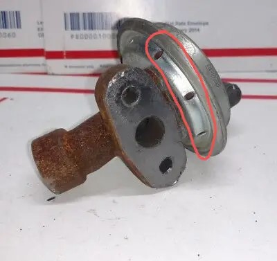

EGR: It would appear that the smoke is coming out from the hat portion of the EGR valve. If smoke can get out air can get it. I don't know if this is something that would change with vacuum applied, if this is a designed in leak (IE: crank case vent), or if it's something cause by the pressure of the smoke machine. Going to be a PITA to replace because the header to EGR pipe ain't quite right.

Some EGR valves are designed to leak. Depends on what model it came from. Take the EGR valve itself off and look around the bottom edge where the openings are. If there is a little piece of felt around the edge, it's designed to leak.
It's the way they regulated the amount of EGR in the older systems. There is a metal plate inside the EGR that is acted on by the exhaust backpressure. Very little back pressure lets most of the vacuum applied to the EGR to leak past, that is what the felt filter is for. As the rpm increases, the backpressure increases, and the EGR leaks less and is actuated more, since the engine can take more EGR if the rpms are higher.
That is why the older EGR's cannot be tested with a vacuum pump on the bench. It's also why the exhaust system from the cat forward is considered part of the emissions system. It's what creates the backpressure to make the EGR work.

EGR Valve: Smoke is leaking out the holes circled in the image below. I've read conflicting opinions as to whether it should or should not leak during a smoke test. Next test I'll pull the vacuum line off the top and see if smoke come out the port, if it does definitely a bad diaphragm.
