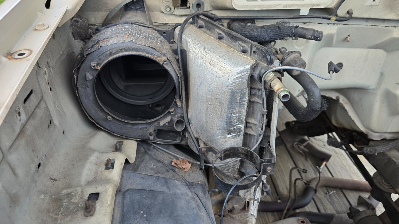

Engine compartment, passenger side on the firewall. Big black plastic ductwork. You'll see the blower motoer sticking out and just below that and a little closer toward the engine, will be a small retangular cover with wires plugged into it. The resistor bank is inside that cover.
Looks similar to this. The big round hole is where the blower lives. Just below is the hole for the resistors.
