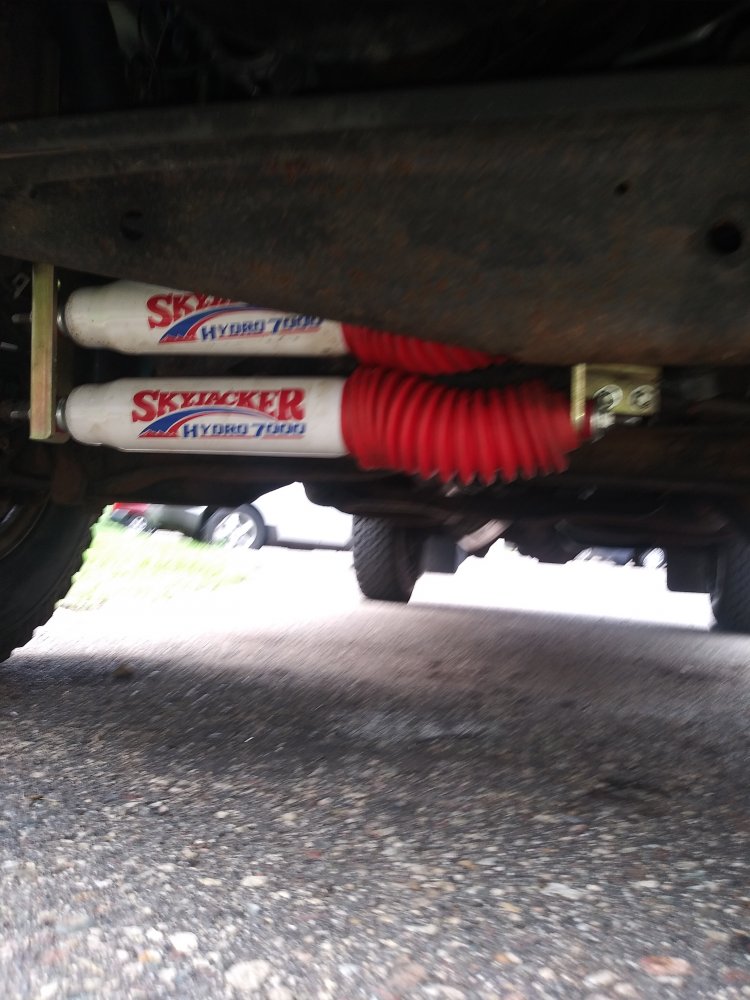

Heres an overall shot of the kit installed on my truck. the stabilizers are installed flipped 180 degrees from whats called for in the instructions because I found the larger end on the upper stabilizer would rub and bind against the sway bar. This problem turned into a non-issue later when I installed a pitman arm from a 4x4 explorer.

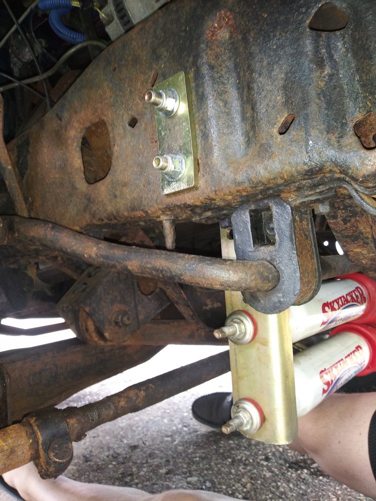

In this shot you can see the two brackets that bolt to either side of the frame rail. they are attached with two long bolts that go through the frame. The instructions say there are pre-existing holes in the frame. That was not the case on my truck at least. there are two oblong holes set at a diagonal on the outside of the frame rail. I lined up the small bracket on those holes and drilled through them to the other side. The instructions say to mount the brackets opposite of what you see here. the long bracket on the outside and the small bracket inside. The sway bar made that all but impossible no matter what I tried.
when installed with the steering centered and wheels straight there should be 4 inches of rod extended from the stabilizers according to the instructions. Swapping the large bracket to the inside of the frame solved my sway bar problem but also brought the bracket inward by the width of the frame rail (roughly 2 inches or so) so I had to make up for it on the end that mounts to the steering linkage to get my 4 inches of extension as required.

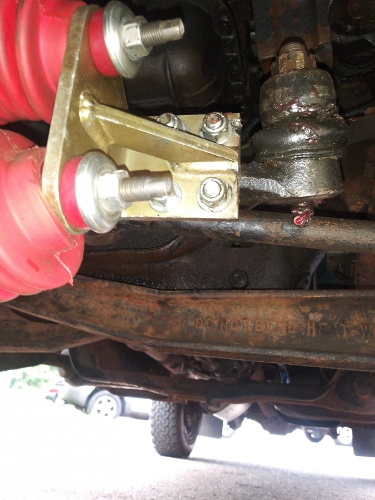

In this shot you see the bracket that mounts to the drag link. it was originally about 1.5 inches longer. I cut it down right at the tip of the welded reinforcement and installed it between the linkages for the tie rod and the pitman arm. I also flipped it horizontally to get my spacing dialed in to 4 inches. It will help if you widen the bolt holes on this bracket by a tiny bit. the u bolts used to attach this bracket get spread out a bit when you put them onto the drag link and it makes it a fight to get them into the bracket otherwise. If I had known beforehand what challenges I would run into and how to solve them, this install would have taken no time at all. like 45 minutes if that. I hope this helps someone out there and saves them some time and headache!
