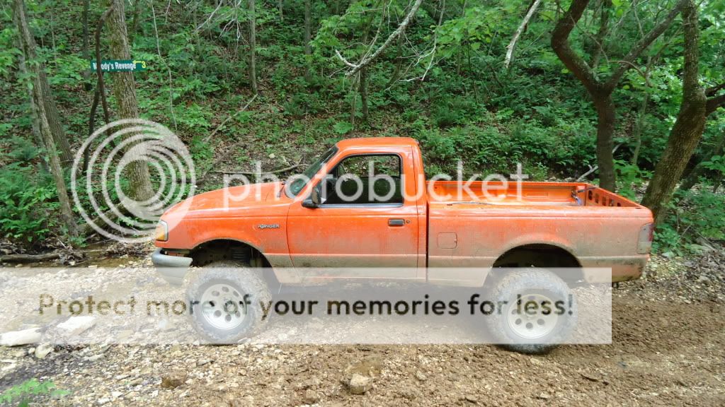

I ave Duff kit on front 5-6 in lift, rear explorer 4dr springs and Bell tech shackles. 2in Body lift, and I'm running 265's for now cause I had them But I like the extra clearance, eventually I will go to a 33. 10.50 tho.
