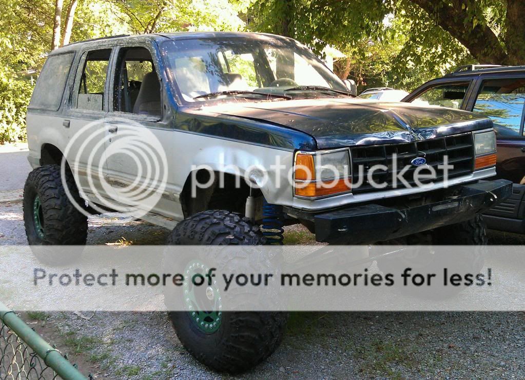

Here is a pic of my Ex with JD 3.5" EB lift coils (175/225 ppi) that are 22.5" free length. They sit on top of my coil adapters.
The rest of the kit was a JD 5.5" lift.

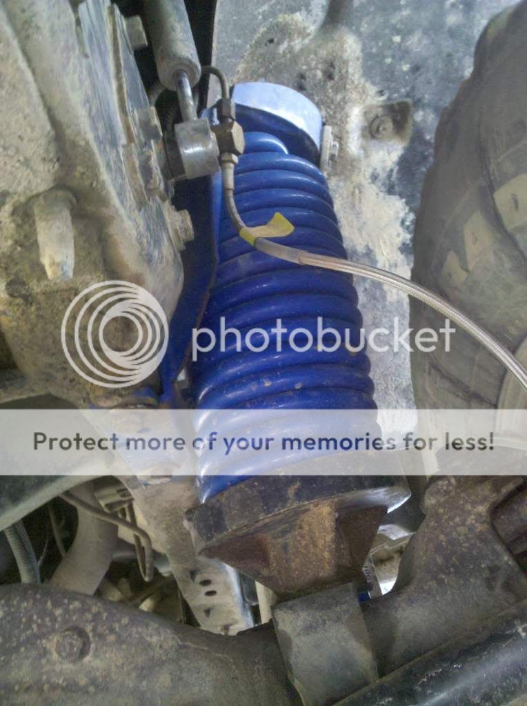

Here's 5.5" EB coils (215/300ppi) 23" free length.
No, they are custom made adapters. And yes, I'm running BC Bronco 3.5" coils with a 1" tall adapter and I only netted 2.5-3 inches of lift. The BC Bronco coils are extremely SOFT. 22" extended length.
Are those Duff's lower coil retainers?
Sent from my iPhone
Kinda sorta but not really. I take the HD lower retainers and weld up the holes then punch a new hole and add the foot and gussets. JD lowers are $75, mine are less than that.
