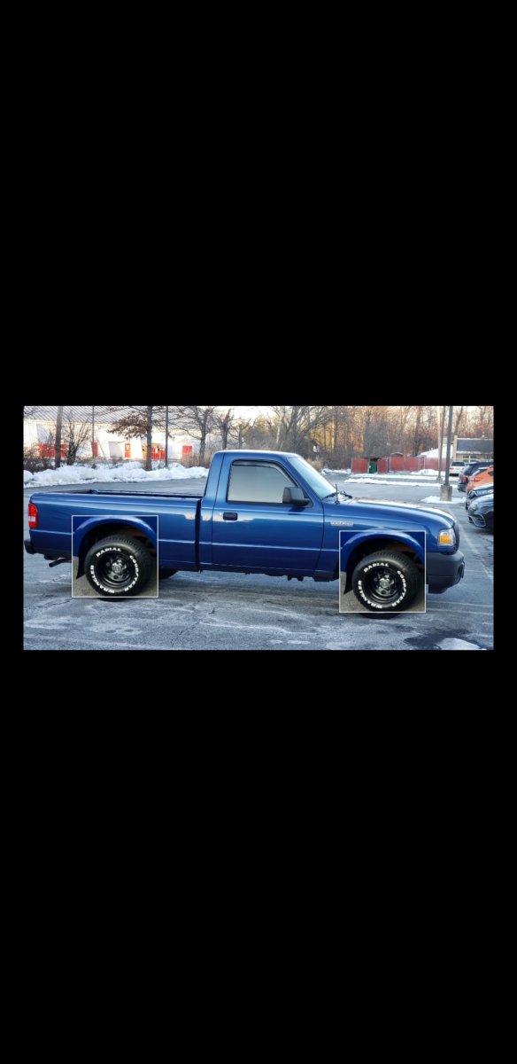

Thanks Garth for the msg that came at the perfect timing. I was just looking for information and advice about how my Ranger is running now with the 275/40 R20 I just put on it as a test. The rims & tires came off a previous Jeep I had and they look so nice I really wanted to put them somewhere else other than in the back of the garage. The bolt pattern happen to be the same as my Ranger so I had to give it a try. And as you might have guessed and already said in your message it won't ride like I had hoped it would. It definitely looks good and I'm getting alot of compliments on the truck as a whole because of its super clean appearance, stance & color, but the ride doesn't inspire confidence. On main roads or highways it actually doesn't feel bad at all, but if it hits any bumps it shakes & wiggles and like you said it's pretty harsh. I didn't lift it or anything, just added 5/16" spacers. Getting the suspension adjusted to make it ride better might be too much work, so as soon as I can get my hands on some 16" or 17" rims & white letter tires as seen in the photo shop picture I'll try to attach I'll change out to that. I'll also try to attach a pic of how it looks now. Your advice & opinions are much appreciated.
