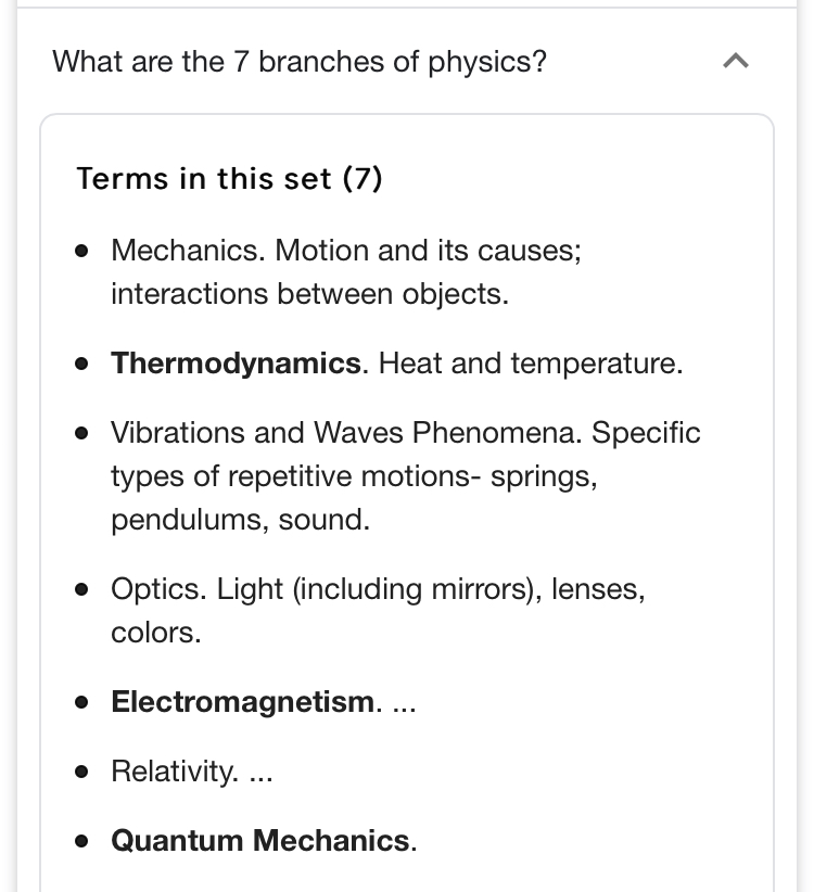

🤔 Point well taken, thanks, but it’s fluid dynamics, not physics. Physics is the billiard ball and driveshaft stuff, or the study of Alka seltzer I think. 😉
Fluid dynamics is a subset of physics. Physics is the discipline of science that deals with all physical interaction.
Hmmmm, perhaps...
Physics is the theory. It is the concept, it indicates parameters that should be considered. While physics is never changing, our understanding of physics is incomplete, and our understanding is still evolving.
Fluid dynamics is primarily chemical engineering, it is the applied science of how the gases (fluids) work in the chambers through the valves out the exhaust, etc., how they expand on combustion, and how they contract while cooling and flowing down the exhaust pipe. To your point about the evolution of the systems from 86 through 97, they are a result of developments in the applied sciences of fluid dynamics, thermodynamics, coupled with advances in materials science (better materials, better steel, better alloys). The jumps in light years in all these things in the last 50 years or so has been based primarily on two things: the development of computers, and instant Global communications and access to data and research.
Physics is the platform, the concept, the playing field. It is the basis of “how” and “why”. Fluid dynamics is the tool, the wrench that turns the nut, the applied science a.k.a. engineering techniques to design the pipe, the mufflers, the cats, etc. We can design the system because we have fluid dynamics. The system design is possible because we understand physics, but it is done with fluid dynamics. So we’re both right, but with only physics, we’d be sitting on the side of the road imagining how the car would go, and with fluid dynamics, we’d be gone!
