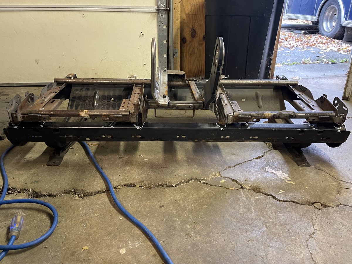

Quick little budget friendly seat swap on a 93. Seats from 2011 ranger, center console from a 95 F150. 0 -> 3 cup holders :) Mate the new seat frame to the old bench slider, couple welds, and cut a hole for the cup holder, done.

Looks good. Did you use the whole bottom frame of the bench seat? IDK much about them. Just curious.

Yep just removed the wire mesh and ground off all the clips on front side to get two smooth mounting surfaces. Also used couple pieces of 1/8” plate to bridge those small gaps seen on the back side where the marks are on the inside of both sections of the 60/40.
