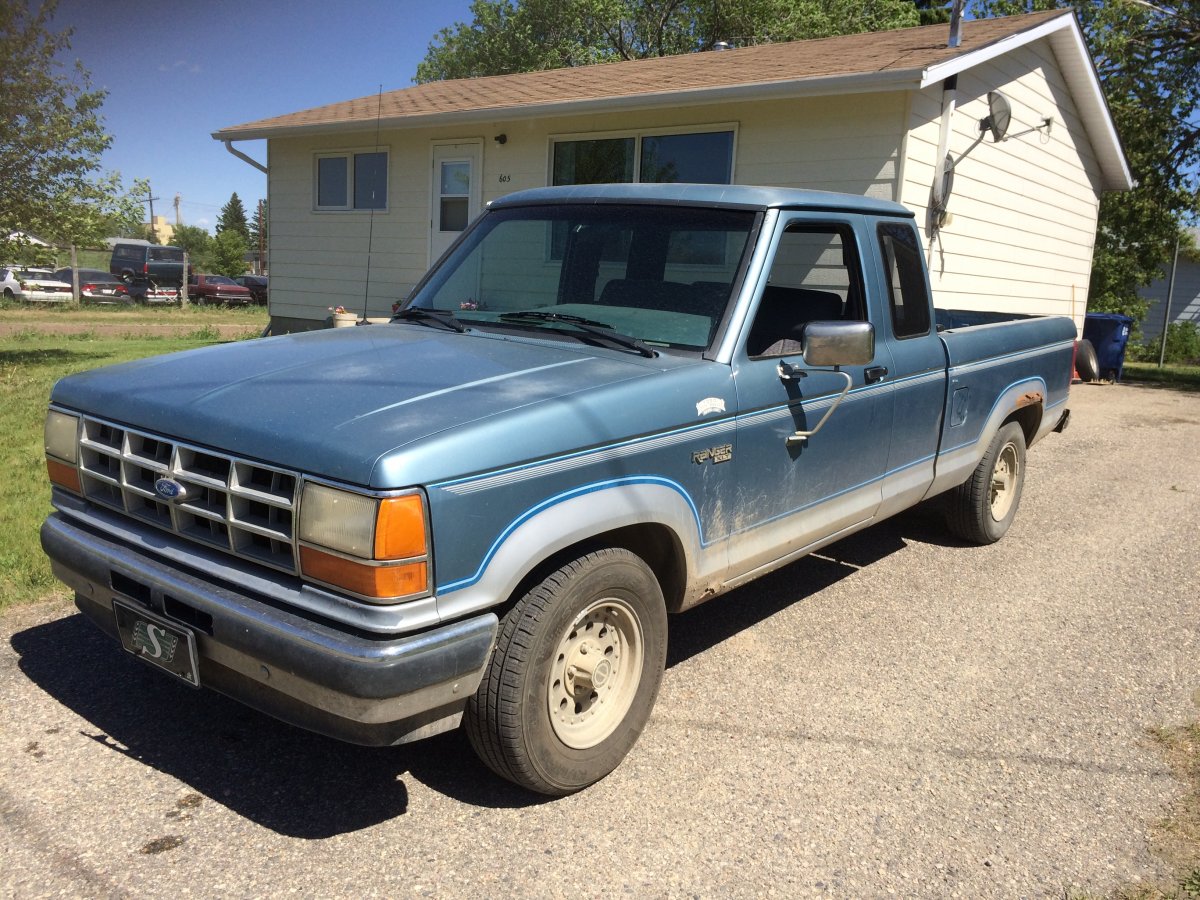

Both brackets are mounted to the outside of the door, as seen in this picture of my '90.
41206

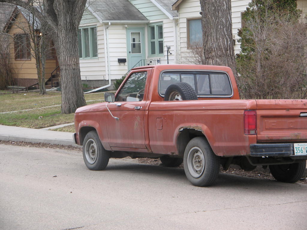

Here's my '85, just to confirm:
41208
The bottom bracket is held to the door by two bolts under the mirror arm. The top bracket has two bolts above the mirror arm.

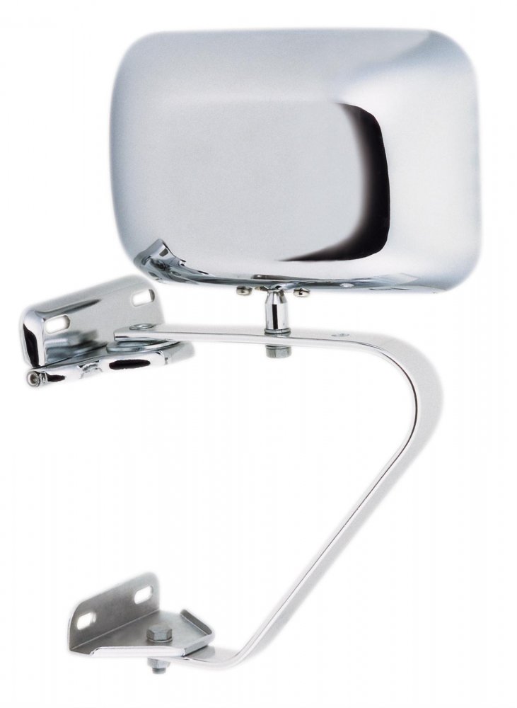

Just to confirm, I found a picture online of the actual mirror (since neither of mine are really close up). NOTE: The bottom bracket on this mirror is installed UPSIDE DOWN. On my two trucks the bottom bracket is UNDER the swing arm.
41209
That bottom bracket attaches to the outside of the door with two bolts. You might want to take it off, and reinstall it underneath the bracket, where it's supposed to be.
Unless that bottom bracket is flipped, I can see it trapping snow and rain, which will lead to it rusting faster than if it's flipped.

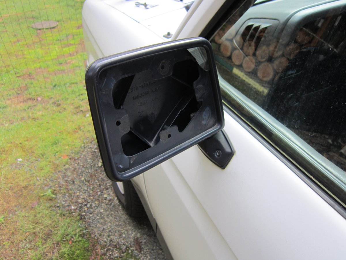

Those look great, where did you get them, I just replaced my '03 Edge with a '92 XLT. She's beautifully free from rust which is really rare up here with all the road salt. My driver's side mirror doesn't hold position anymore and I'd love to replace it with chrome but I don't want to put any new holes in the door. I haven't been able to find any chrome mirrors that use the original holes.
I need to do something about mirrors, too. Trees and rocks have been attacking mine. And then, recently, some idiot (i happen to know him intimately) was grinding steel nearby and now the glass is pitted and rusty.

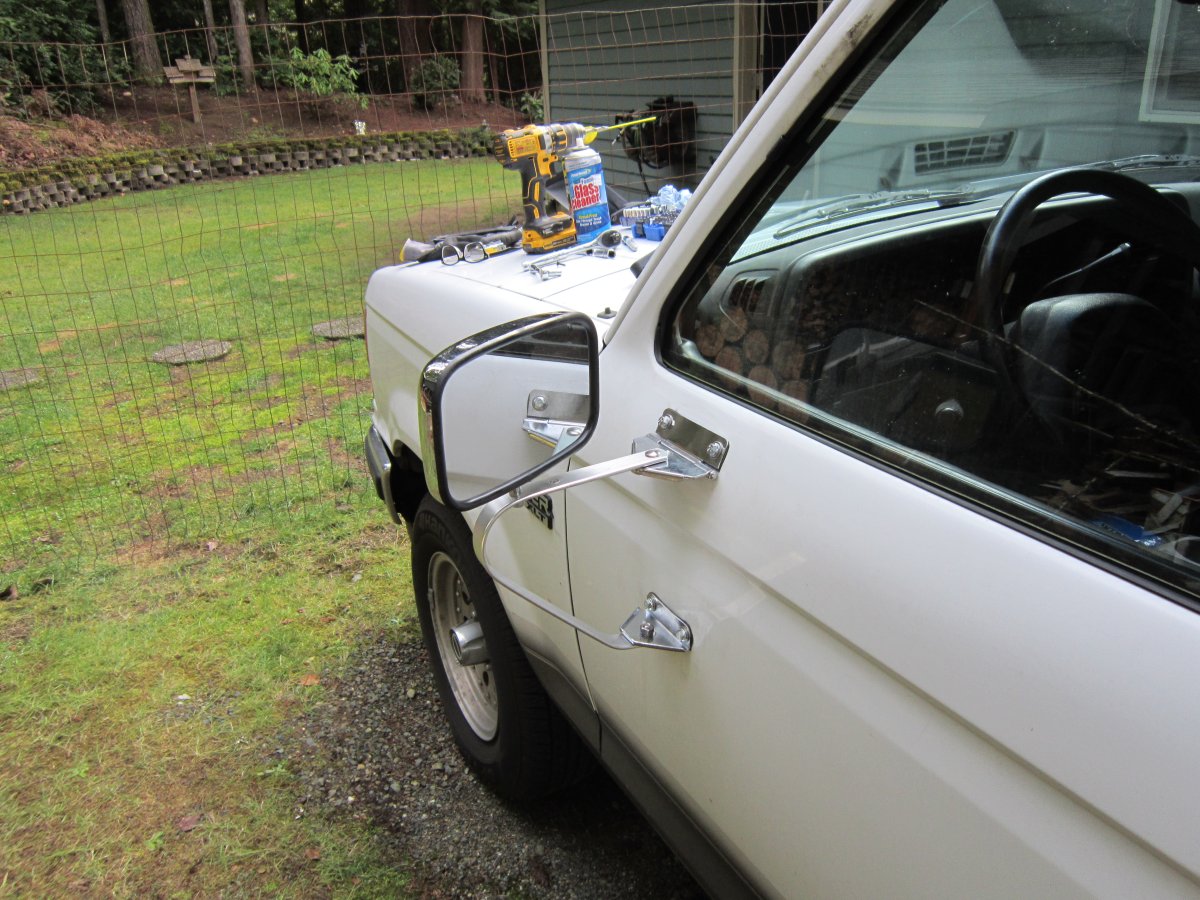

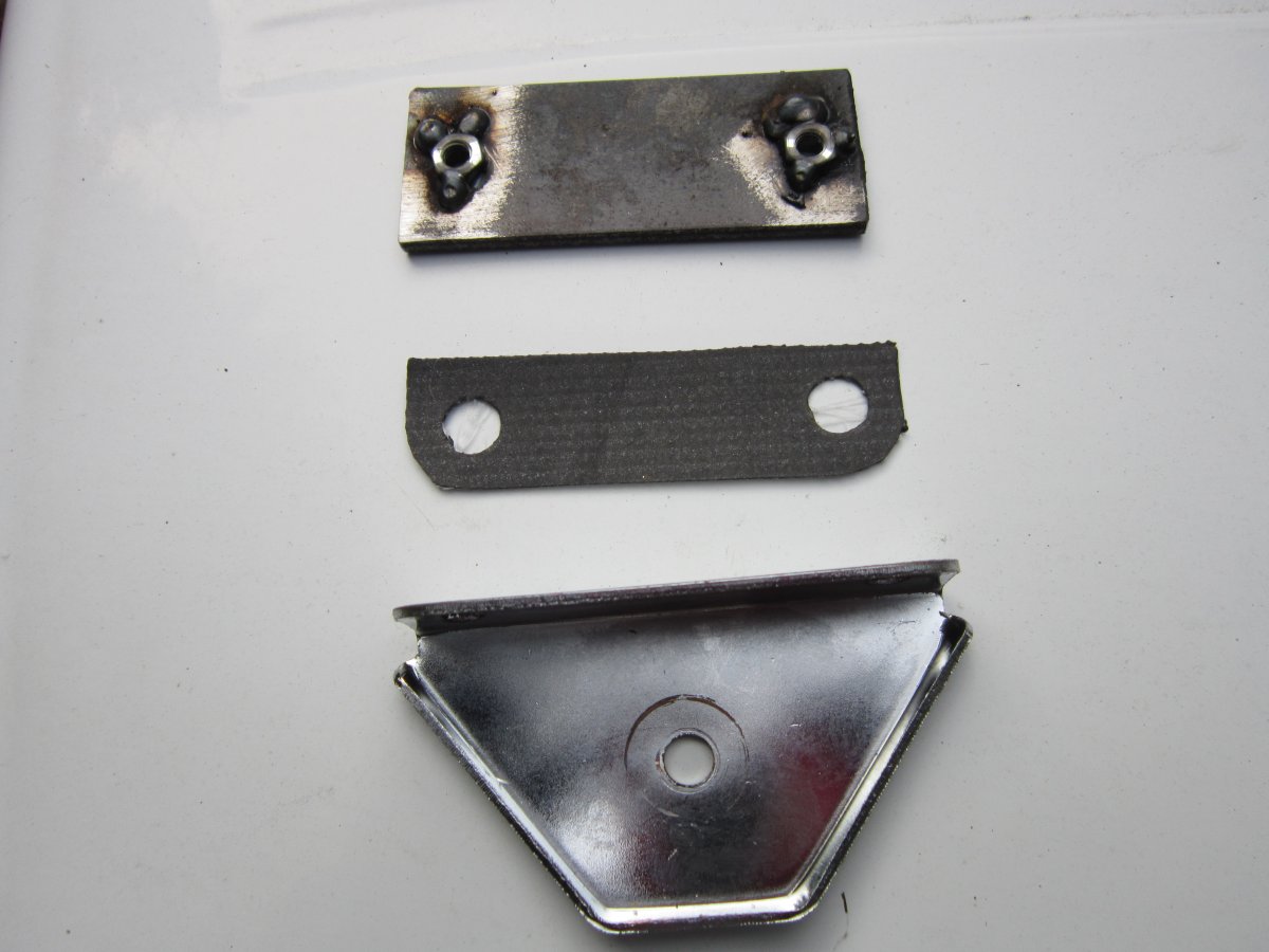

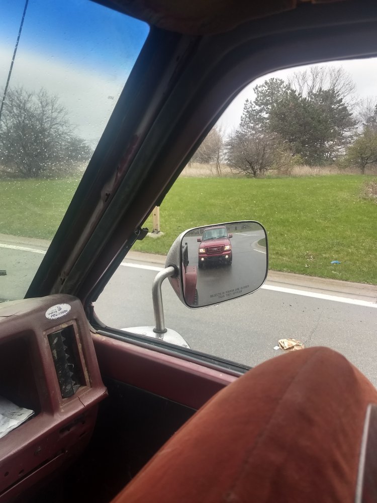

I had to drill 2 holes for the lower mount but the top bolted right up. I also made a bracket for inside the door for strength.
73668
73669
73670

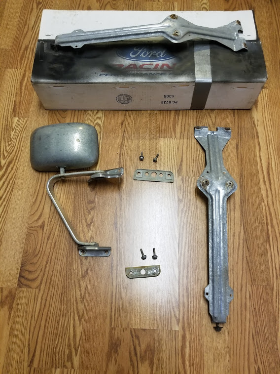

The door panels are still off My Bronco II... and if I remember right... there is a brace that runs top to bottom inside the door that both the upper and lower mirror mounts bolt to. I can probably take a picture tomorrow. I only mention this because that brace will prevent the mirror skin from flexing.
That brace is shown in Silverslug's picture above. Until now, I had always wondered what bracing might be inside the doors.
Yeah I don't want to put the holes in for the lower bracket, I've found ones that fit the original holes online just not in chrome.
I missed that picture... but it looks just like mine.
I did look for the brackets, to which there was none, before I threw the ones I made together. My guess is only doors that had the option of the larger mirrors had the brackets.
