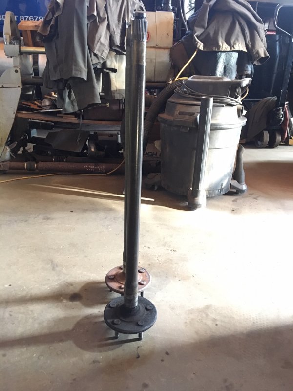

That is a bent axle shaft for sure (a warped rotor normally wouldn't have the wheel & tire also wobbling).
I don't know how long you've had the axle, but I'd suggest check with where you got it and see if they'll give you another shaft & caliper (and also a rotor too if needed).
This is one of those things anyone buying a junkyard axle should always check for. With the number of vehicles that get decommissioned & parted out due to collisions, unseen (or concealed) damage like this is quite common.

Yep that axle shaft was definitely bent. It was hard to picture, but you can clearly see it in this picture. The one in front is the old shaft, the rear one is the one I pulled from a JY truck the other day. Notice how the front one clearly bows to the right. Anyway, long story short I replaced the shaft, the bearing and seal on that side as well as that caliper. The truck drives better, it's noticeably less shaky at all speeds. There is still the mysterious 40-45 shake, although it is much more tolerable now. All other speeds are pretty darn smooth.
