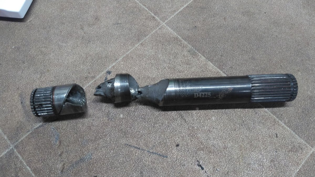

Haven't really wheeled this truck in a couple years so I figured I'd take it to our club event again this year. I trail gunned on Iceman (6/10 trail, moderate difficulty) on Friday, led it on Saturday and then my wife took it out on Sunday for the girl's run. Performed well enough but I destroyed a front RCV axle shaft on Friday:

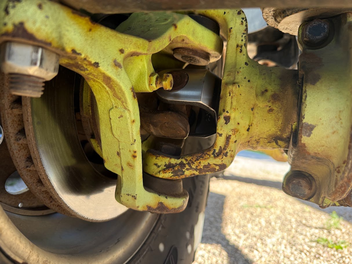

And destroyed the lockout hub, and the spindle bearing...........
It was on this obstacle (not my truck obviously) which is not particularly difficult, I just had the wrong line on it, my cab corner got hung up on the big rock, tried to drive up the wall further because I couldn't hear my spotter, then almost tipped over when he told me to keep driving forward :ROFLMAO: Had to winch out, remove the axle shaft, drove back to town and fortunately I had a spare and O'Reilly had a spindle bearing. Back on the road for the rest of the weekend.

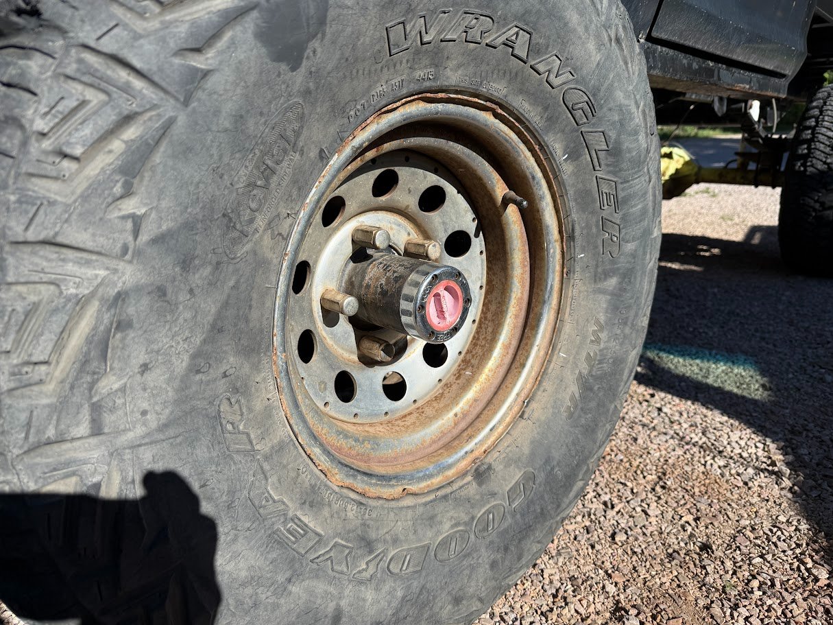

Warn won't warranty my broken hubs so I picked up a set of these babies. Spendy but not much else out there besides drive flanges for a 30 spline D44 application. The old Ford hubs of this design were bad ass, I'm sure these will be even better.

Small update - those Yukon hubs are pretty cool. They are sometimes hard to unlock...guessing they get bound up like the old Ford ones do. Have not broke them yet though.
