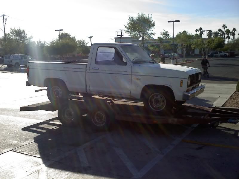

I just picked up a 83 Ranger and I am going to put a 5 liter in it to along with a T5 trans. I have been looking for on of these trucks for quite a while and I finally found one for a great price. It a regular cab short bed 2wd and I am going to do a prostreet look to it. I am going to run 3.5" skinnys in the front and 10 fattys in the rear and lower the truck down on them for that look. I am looking for any info on doing a a V8 swap on this year Ranger. I have a 94 excab that is done and running with a EFI 5 liter and a 4R70W trans and its a fun truck but I love the look of the 83-88 much better. I will post up more pics of it soon as this is the only one I have right now. I am going to try a take pics all the way thru this project and post them through out the build. Any info that you guys can share would be great.........Mike. :icon_thumby:

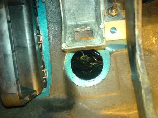

Mockup, not the final postition, but close:
The slave is now pushing the area where the large hole is on the clutch arm. This give less leverage, but much more throw/movement of the clutch. Even in this location, the pedal is only a fraction of the effort required in my (cable operated) Mustang.
