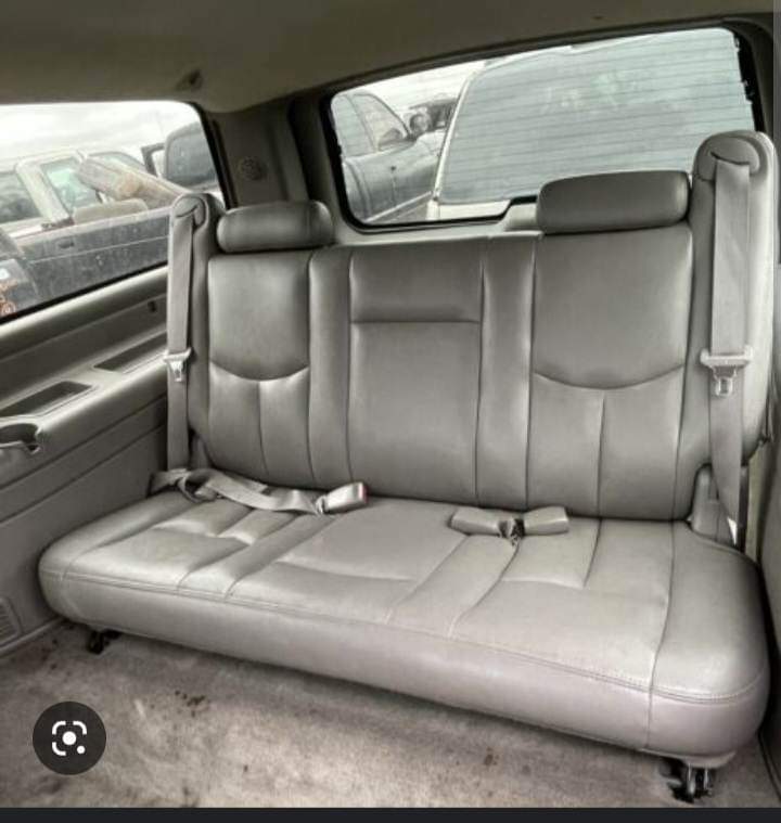

Have been looking at suburban and tahoe 3rd row seats, but the suburban I know is 47.5" wide, unknown about the Tahoe. I need something like 44".
This is the suburban seat.
Could I just chop out the center part of the frame, and have the covers narrowed down?
