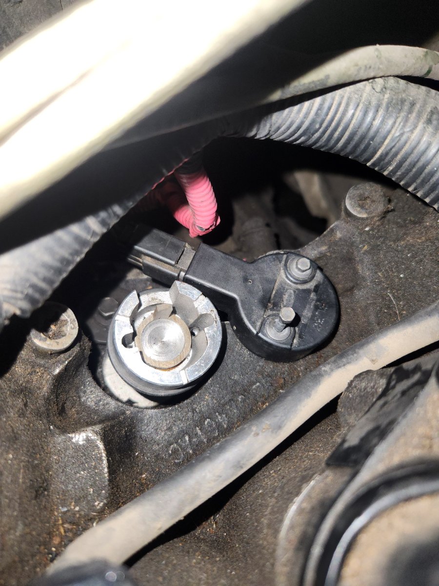

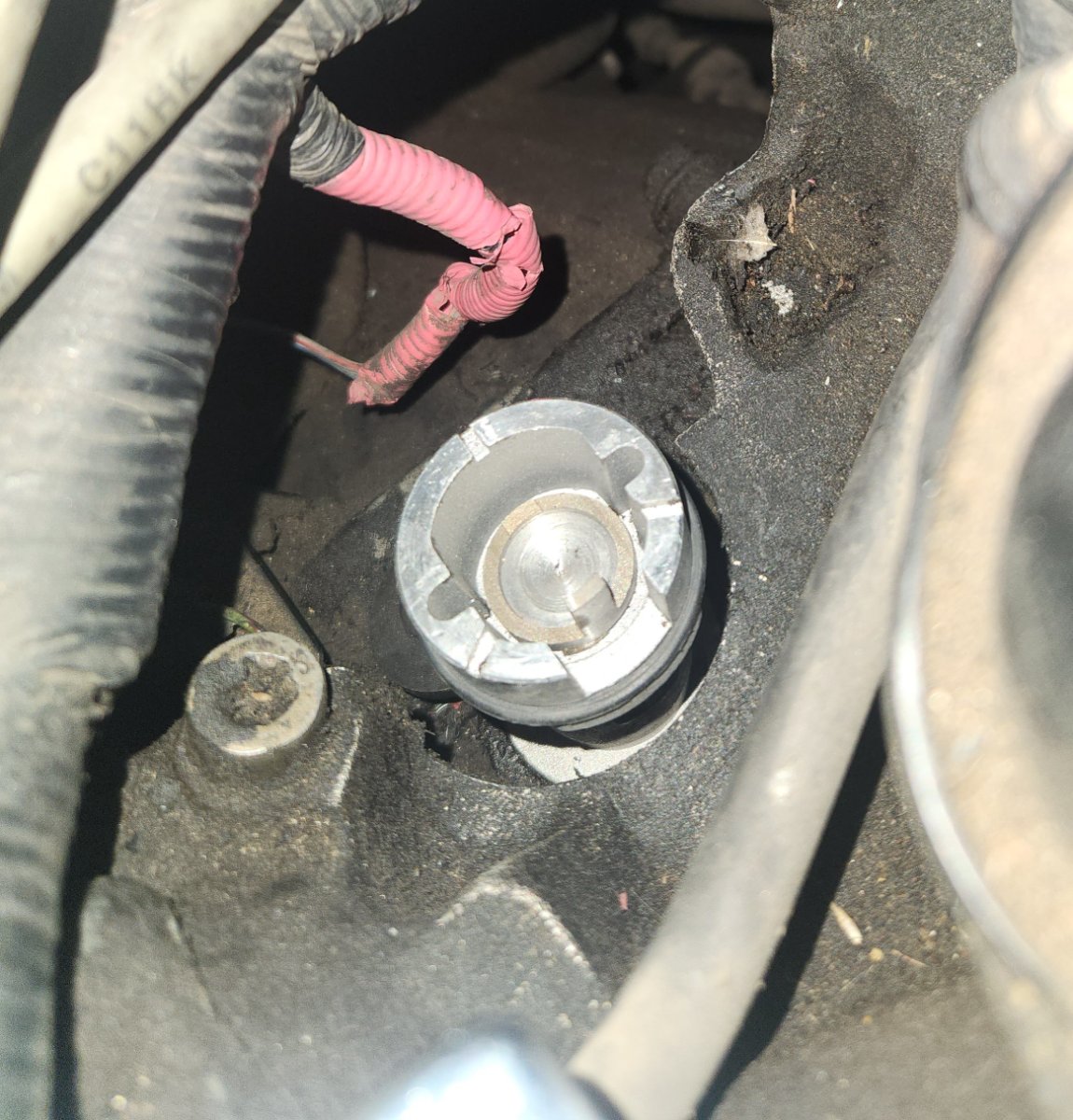

In "Checked 8-31" is where it looked like it was out of time.(I turned the synchro housing around to try and put the sensor on so it would be in time but it wouldn't fit and I forgot to turn it back.) I SWEAR I had it all lined up just the same then. The other picture and video are from today.
On the crank pulley you will see my friend's mark which from this thread I learned is one tooth off. I need a separate flashlight to show you but the tooth lined up to the crank sensor is marked TDC. Okay never mind the video won't go it's too big. I could do an email if y'all want.

at TDC compression the window should be pointed at the bolt and the tab should be centered in the window.
they both point at the hex bolt that holds the clamp down. (the big washer)

if the "today" pic is at TDC compression that's close enough for the tab, just rotate the housing to center the tab in the window.
the most important item is the tab must be centered in the window. pointing the housing at the bolt is mostly just where the sensor and wiring
are in a convenient location.
