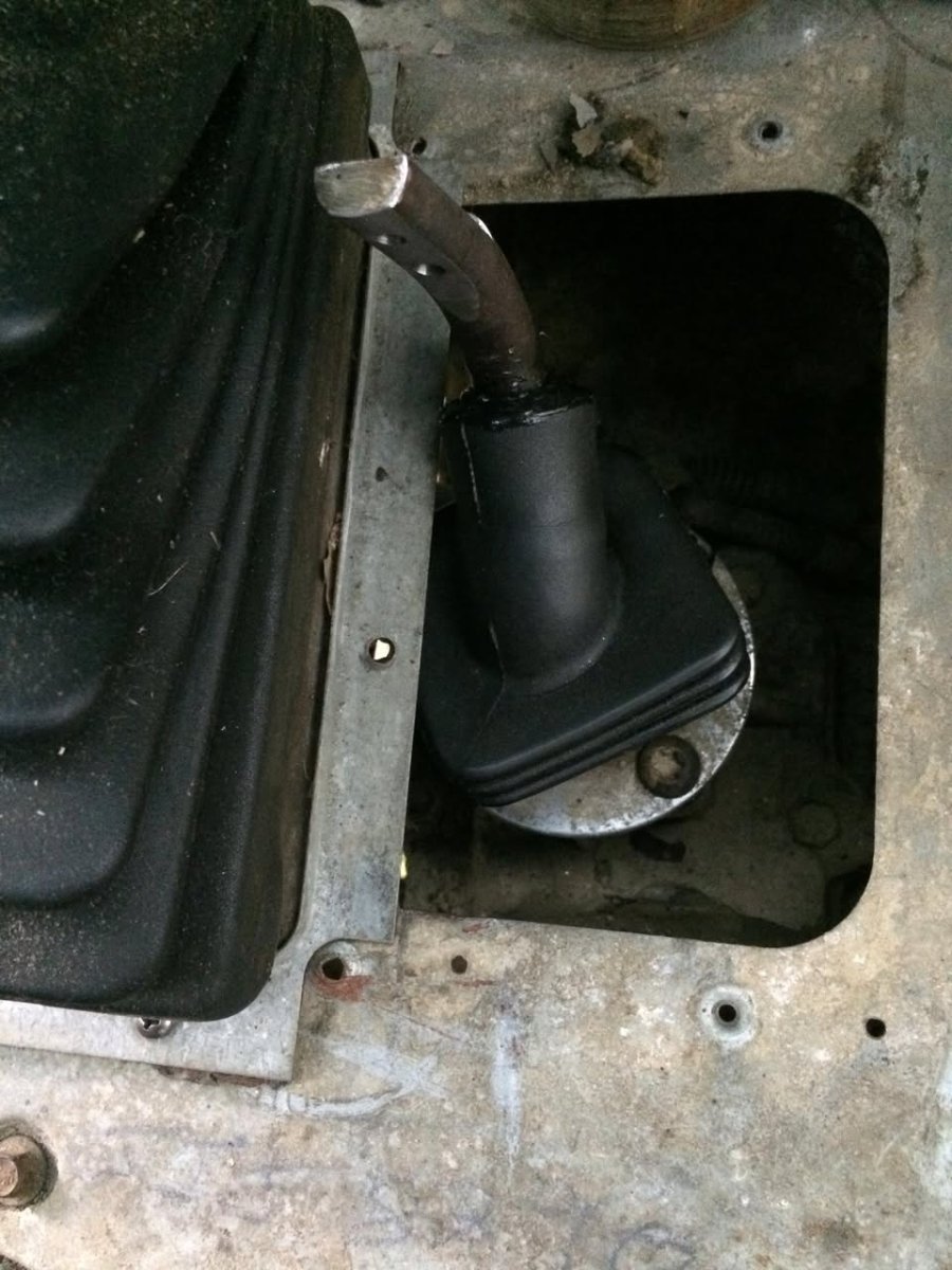

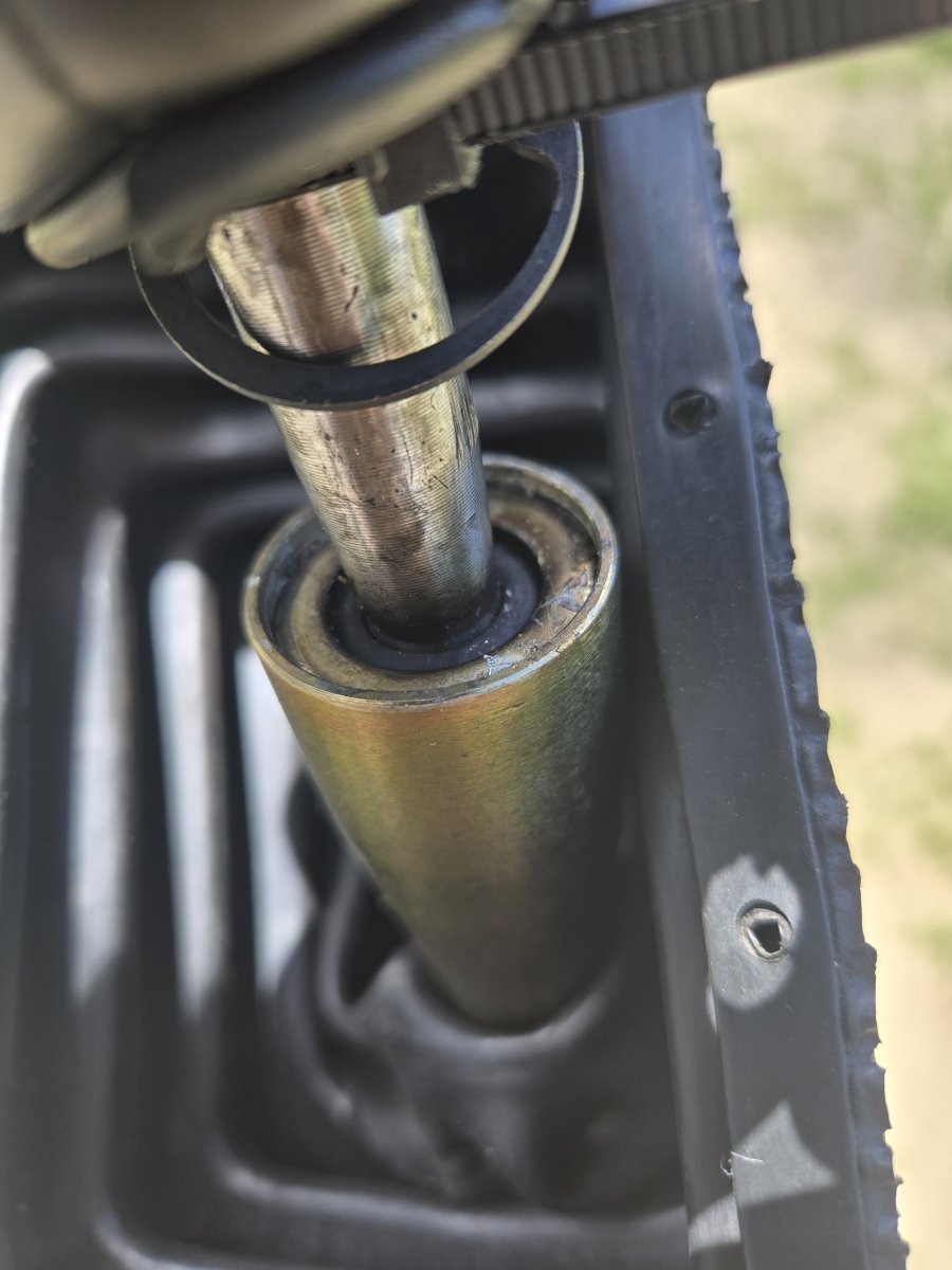

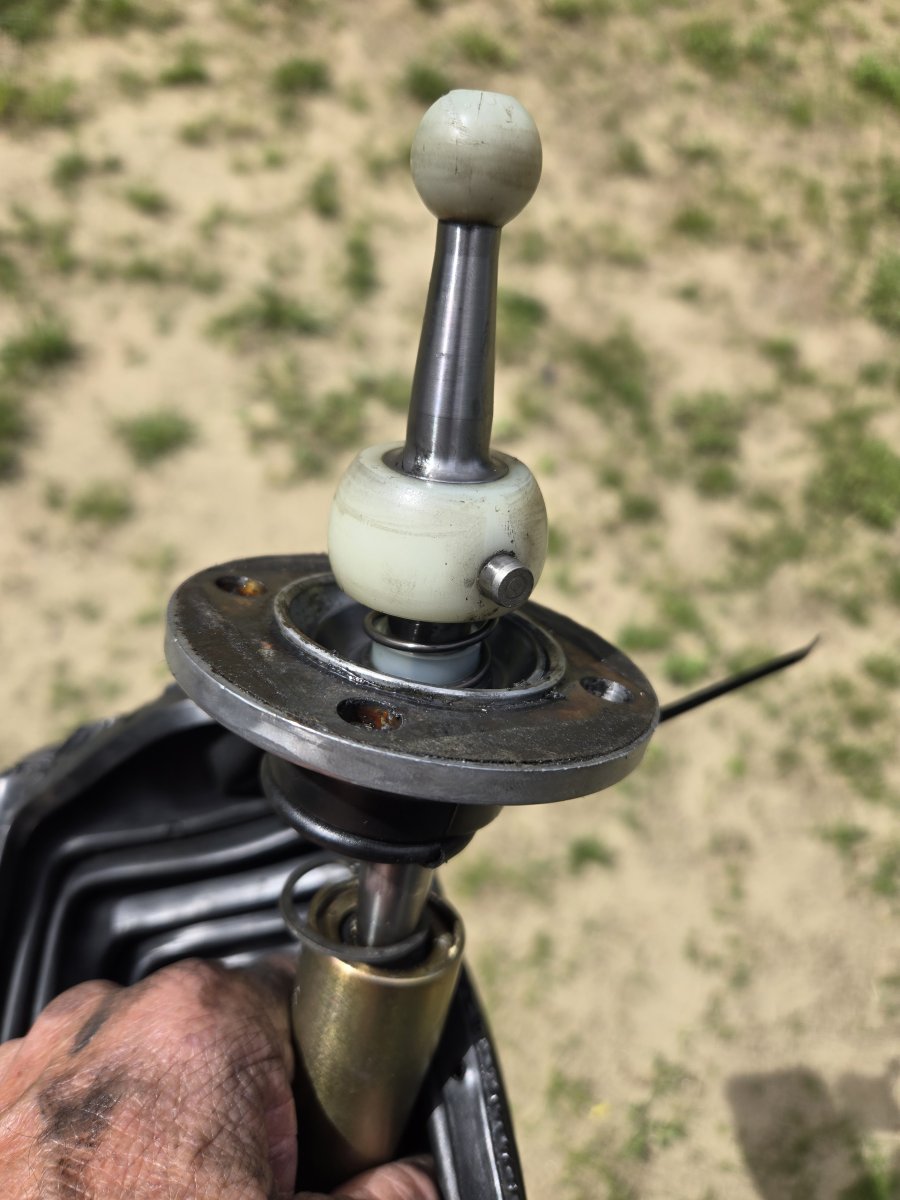

Remover my 1988 ranger manual shifter. Wondering if you can remove shifter arm from linkage. There's a c clip I took off at bottom of arm and trying to remove arm from linkage. Found a 3/4" CV boot im hopefully will cut down and make work. Any suggestions how to separate?

That looks similar to the M5OD shifter. I've taken one of those apart, but it quite destructive. I just wanted bottom stub to build a custom shifter.
You might melt that rubber out with a propane torch and replace it with polyurethane from a skateboard wheel molding kit, when you're ready to reassemble. You might also ruin the shifter in the process.
I cut the one in my FM-146 years ago just below that rubber filled section and turned it into a stub (ground a flat and drilled/tapped for bolts). Used a shifter boot thing from a ZF5 and made my own upper shifter out of a piece of rebar.
I would try to use a press. I imagine that's how it was put together. But I have no real knowledge. If I remember I have an old transmission I can pull the shifter and try later this afternoon.

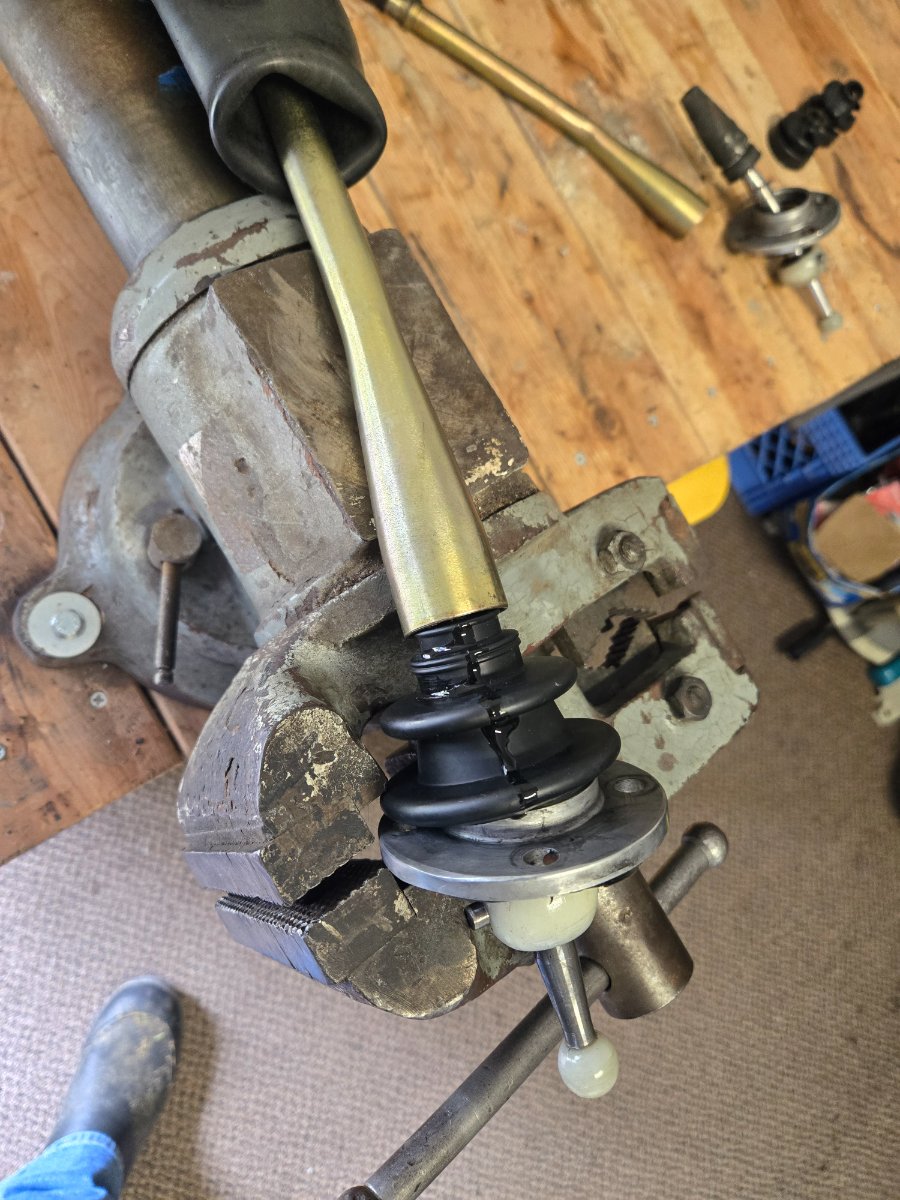

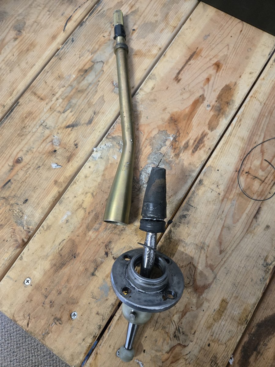

Ok got the rubber pressed insert out of shifter arm. Just so people know what it is.
Shifter removal

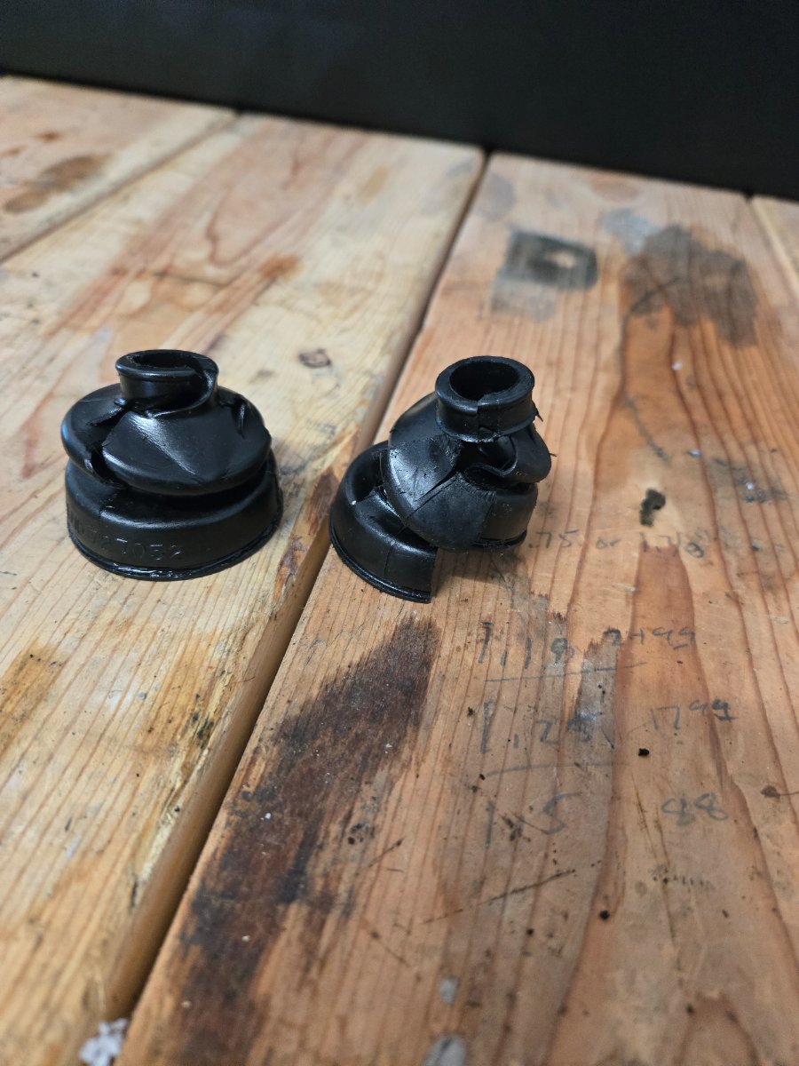

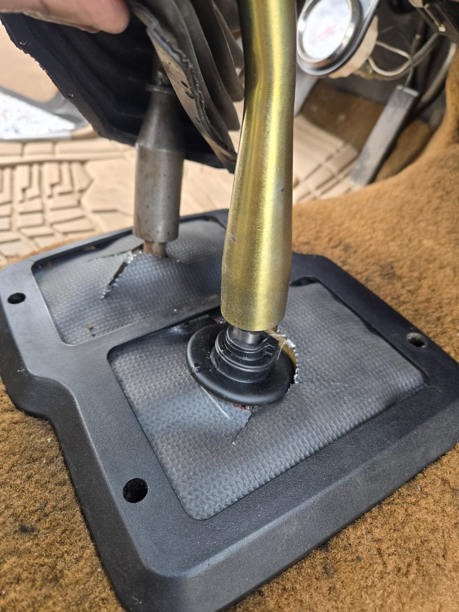

sent a pic. Used a 13mm around linkage arm and just tapped it out. This was off a donor truck just wanted to see if possible yes it is. Anyways I ordered this split CV boot off Amazon and installed worked great. Pulled linkage/ shifter out to do it. Put down some things rubber then the factory foam then another thing rubber should stop dust and road noise now. Thanks for all the input guys.
Thanks for posting that "exploded view" picture.
