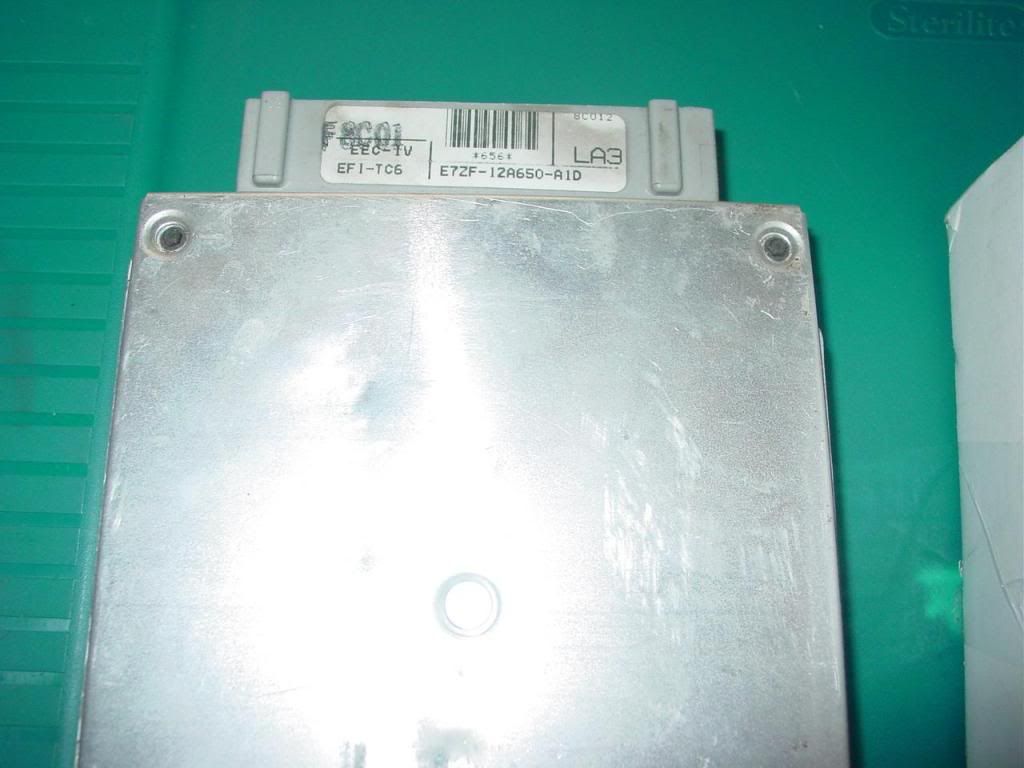

So far I have a 2.3 turbocharged motor from a xr4ti installed and am running a PK1 comp from a automatic car. The LA3 comp I have will work with the large VAM and can compensate for the intercooler and works with the 35 pound injectors.

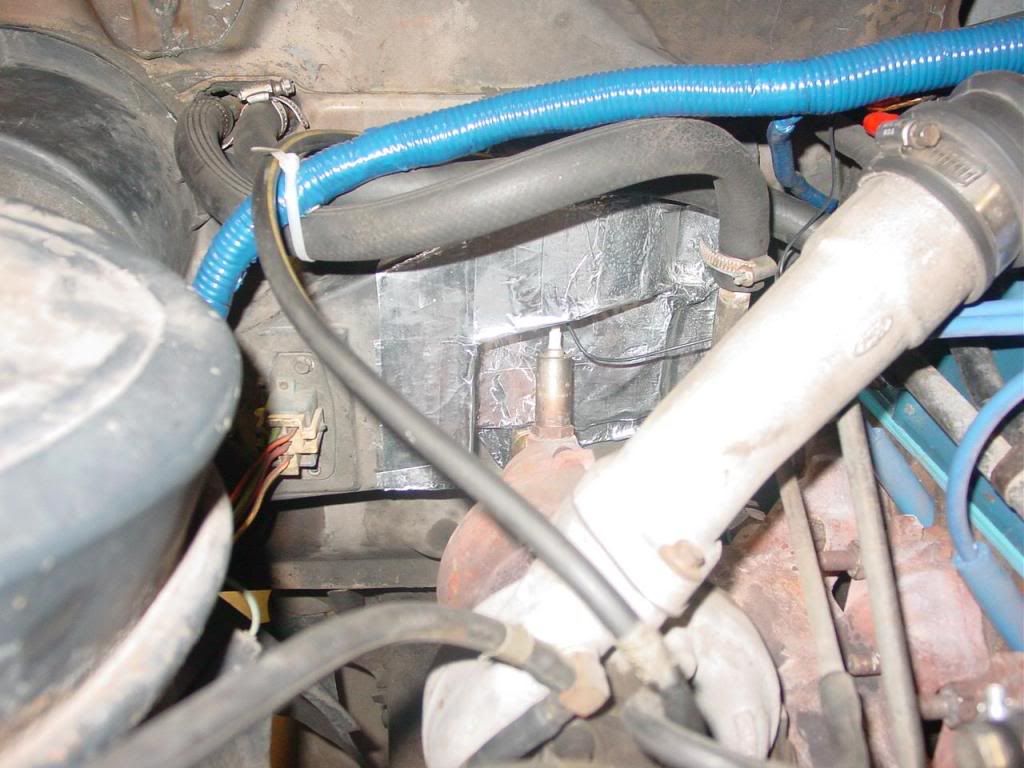

Had to cut out some of the heater box for room for the oxegen sensor.

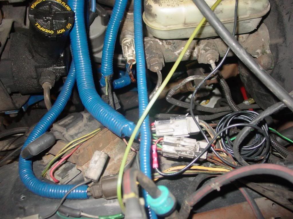

these are the harness connectors from the engine harness to the chassis harness. The XR4TI harness has a different connector so you have to repin the connectors from your Ranger wire harness. This took me quite a bit of time. I took all the tape off the Ranger harness and traced were the connector wires went. I used the pcm pinout diagram for Ranger to help me figure it out. So far all my guages still work but my temp guage. Am working on that, think I missed the sensor ground.

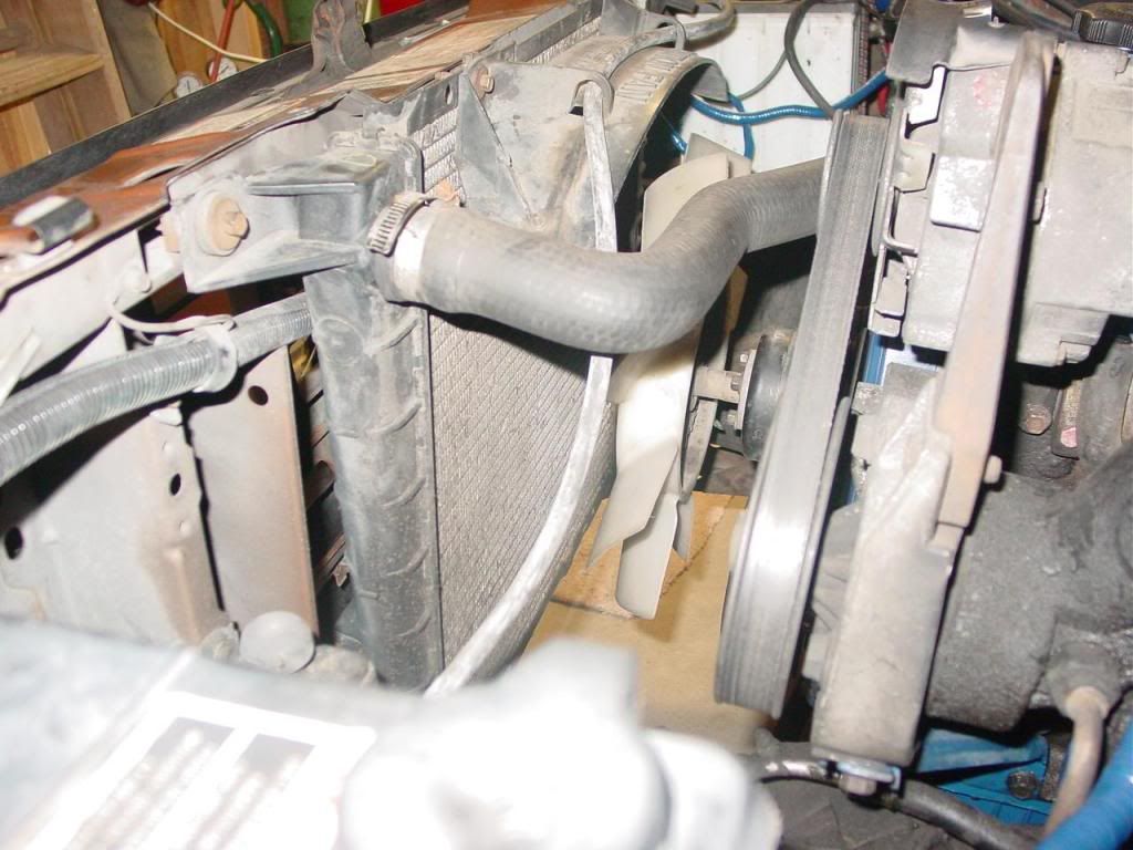

No intercooler yet, but lots of room.

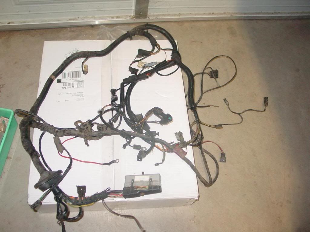

http://i467.photobucket.com/albums/rr40/egausten/HarnessfromturbocarthatIadapted.jpg
This is my spair harness, It was a great starting platform for wiring in the new engine harness. Needed pcm pinout for ranger and merker, guages had to be wired in to the chassi harness.

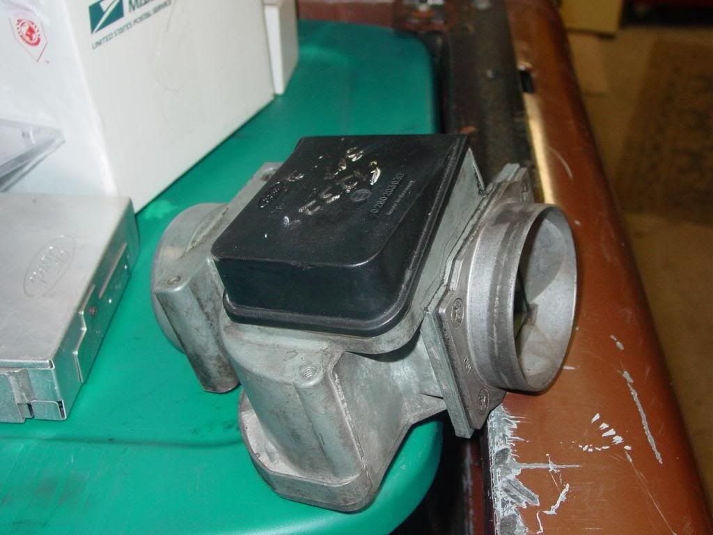

http://i467.photobucket.com/albums/rr40/egausten/Largevamairmeter.jpg
Large vam air meter

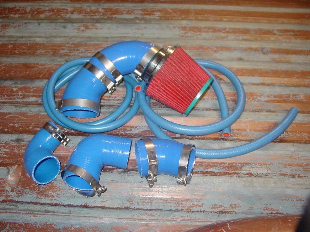

http://i467.photobucket.com/albums/rr40/egausten/Newairintakeandsiliconeheaterhoses.jpg
This is the silicone Intake I frabricated.

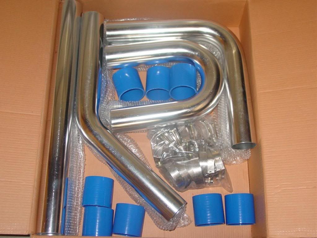

http://i467.photobucket.com/albums/rr40/egausten/Intercoolerpipingkit.jpg
Pre packaged inercooler piping kit.
