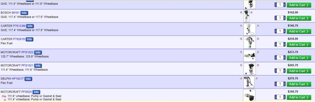

So I jumped on Rock Auto and they have a pretty big selection. I took a couple screen shots of the "daily driver" options they have. Any of these brands stand out as a definite get or definitely do not get?

motorcraft is probably a good choice :)
i have seen delphi on other forums being used and seem to be ok, bosch has been good too
I ended up ordering a Bosch from rock auto which should be here this week. Was driving yesterday and the engine light came on and it was the P4061. I wasn't really in a hurry to replace the sending unit but since my son is a new driver I don't want him to get used to driving with the engine light on in case something else pops up. Hopefully I can find a day in the next week or so to get it swappped out. Going to slide the bed back, not drop the tank.
