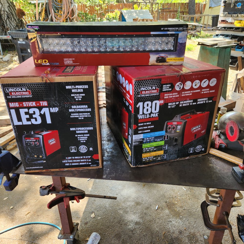

So I ended up with these. New old stock. They wanted $700 and $750, but talked em down to $650 each if I bought both...and did.
Sketchy pawn shop lol, had some good stuff though.
