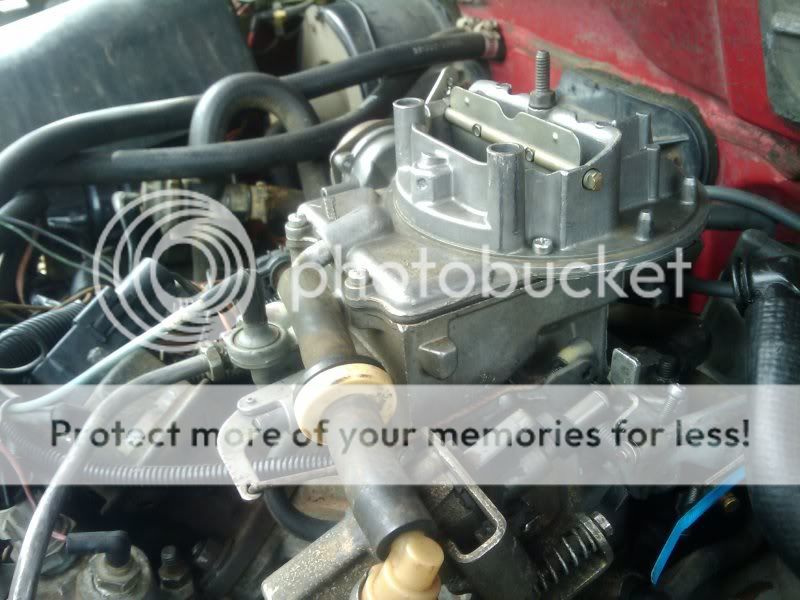

Im about to rebuild my carb
1st one too...
i have the step by step from the tech library
But before i rebuild this id like to get your input of seeing if anythings wrong..
Sorry im a little new and dont wanna rebuild a worthless carb you know!
Pics are with cell phone might be blurry
Let me know guys and thanks for your time!

Looks good from what I can tell. Once you get it apart you will get a better idea of what your working with. It's a pretty simple procedure. Me and my brother did a buddies in an hour and a half. Off the truck rebuilt back on. Yeah we should have let it all soak overnight to get her good and clean but it's a daily driver that was needed in the morning and this was the only chance we had to do it.

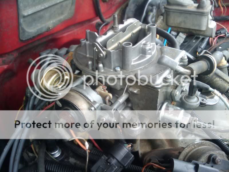

i noticed that on the 1st picture theres a gold cup type thing towards the center left of the pic... There is supposed to be a screw behing there huh? becuase nothing is there...
NOTE: THese pics were taken when the cars off... so if anything looks odd lemme know becuase my cars idle is stuck at REALLY HIGH sometimes and thats why im rebuilding it..

It looks so clean, check that you don't have a vacuum line broken somewhere.
1200 ppm CO, maybe means running rich. Yes make sure you don't have a vacuum leak, and all the aforementioned items.

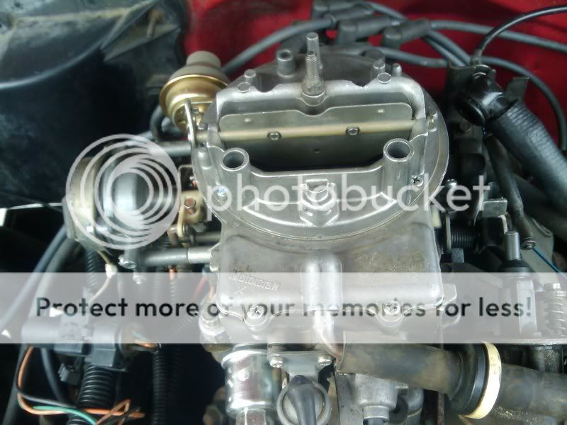

What causes a stuck idle... look at the pics....
I think I'm missing a screw on the gold diaphram on the passenger side I felt back ther and didn't feel the screw wasn't there... would this cause stuck idle
The gold diaphram thingy on the passenger side is the choke pulloff. It opens the choke butterfly slightly on initial start and has no effect on anything unless the choke is completely closed by the choke temperature control (the round black thing on the passenger side). The hot idle is set by the idle motor on the front drivers side. It's controlled by the computer but has to adjusted initially by hand. With the motor running at idle the arm should be resting on the plundger of the idle motor. If it's not, check the fast idle cam (middle on passenger side) it may have stuck or someone might have asjusted the screw too much which will not allow the butterfly to return to its proper idle position.
Gold diaphragm most likely will not have a screw, Autolite(Motorcraft) carbs are easy as pie to rebuild. Friend and I did one overnight , got it running great and all we did was follow directions, we were clueless BUT we knew that.
Follow the instructions,rebuild it. Put it back on hook everything back up checking for vacuum leaks and everything hooked back up see what happens.
