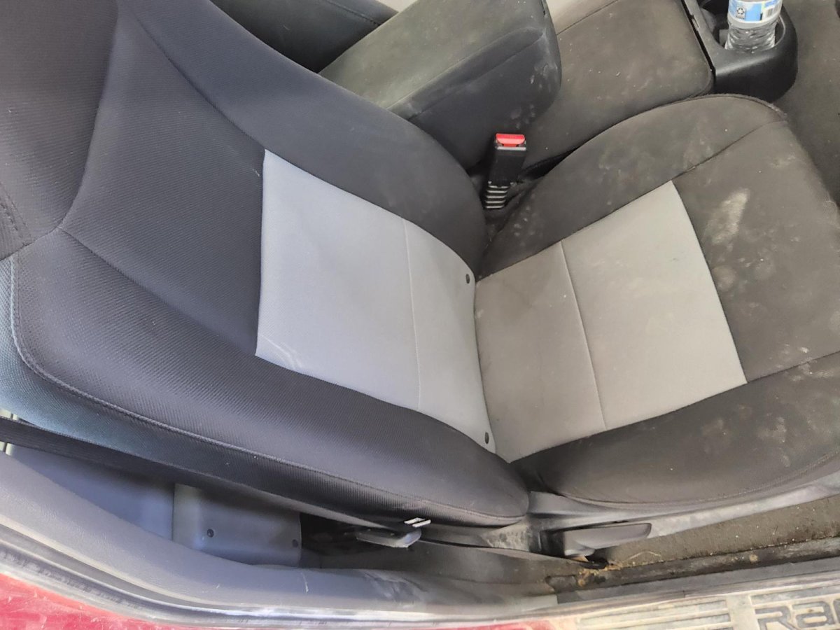

Which year of ranger starts to have the seats that look like this ? I want to bolt some into my extended cab 1996. Is the cloth as tough as on the older seats ? I much prefer the dark look of these seats.
I’m not sure on the years but the light gray middle stains easy. The fabric itself has held up well in my 2011 with 101,000 miles on it so far.
