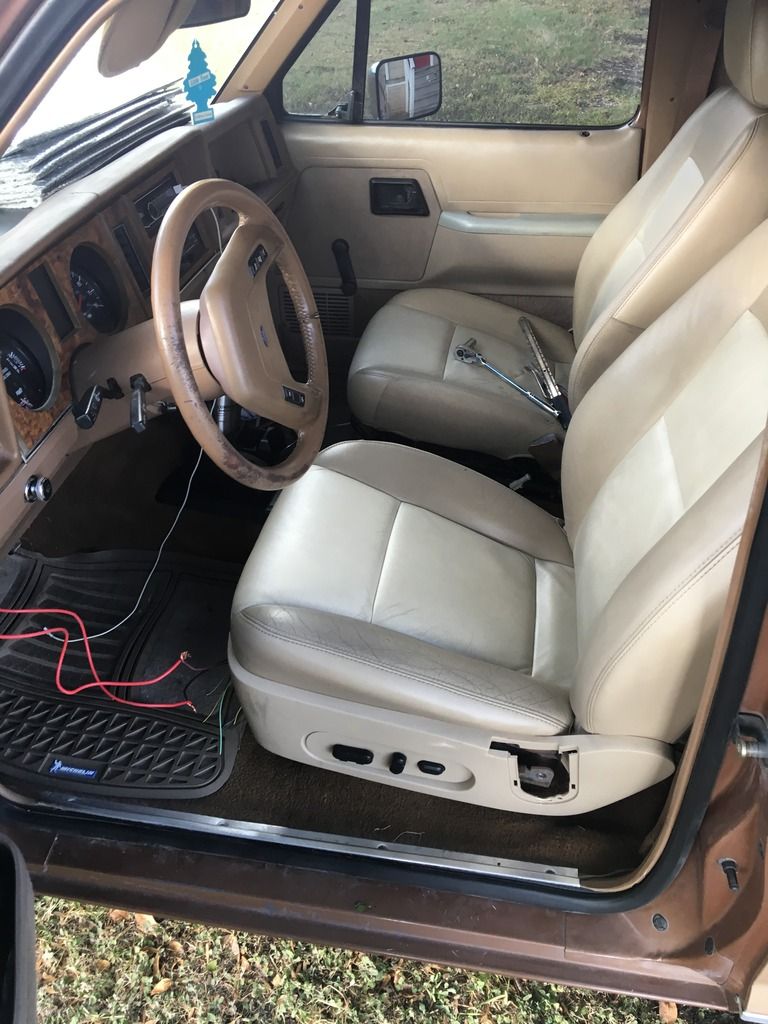

U can put any seats u want in that truck. With a little thinking n cutting my oem brackets n welding em on these 06 explorer seats i was golden in about an hour. Filthy cuz its sidelined being bagged rite now but heat n power work just fine
