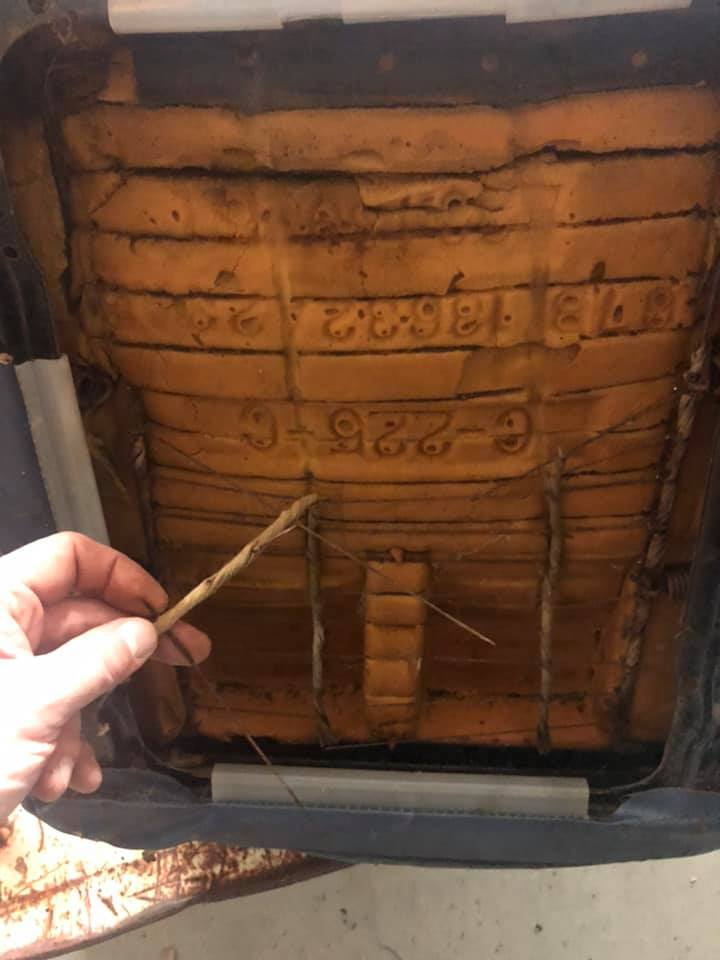

Probably no surprise to any of you (nor myself after getting a look at it), the seat PADDING is actually in pretty good shape. The cave-in is due to the support wires on the base of the seat being rusted/broken. That is something that I can actually fix on my own. I got the seat tracks freed up with copious amounts of PB Blaster. Hopefully the bolts will come out ok. The seat frame is in bad shape. really bad rust on the mounts.... I didn't study them too much because of the time (off work early at 3am), but they look like flat stock that's formed and welded. Shouldn't be too difficult.
Took the driver's seat out this evening. Turns out, the foam is ok. Has a couple of spots where the wires cut into the foam. The wire supports are what came apart... well... rusted apart.

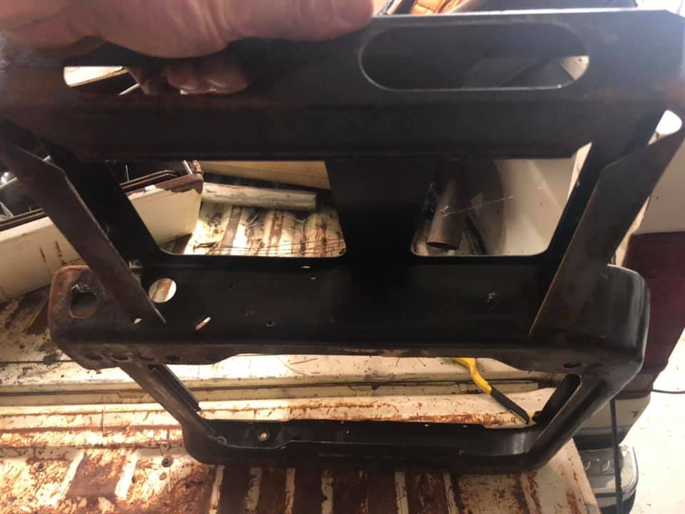

I took the sliders/mounts off of the seat frame. They're soaking in rust remover right now. One of the mounting tabs is pretty ate up with rust. I might look tomorrow to see if I have anything worth making a new plate out of. If not, I should have a little bit of sheet metal in the shop that I can use to help add some beef to what's left. Maybe. Will see about that tomorrow.
I got the frame cleaned up a little.
42788
Since that was taken, I sprayed the bad spots with some rust inhibiting primer. I'll paint the frame tomorrow along with the mounts.

With the cuts in the foam from the wires, I think I'm going to try and dig up some heavy material to keep it all together.
My temporary... but better than it was... fix.

That rope is rated for 300 pounds.... So it's not going anywhere. With the cardboard, the foam will "see" a flat surface and keep the rope from digging into the already cut up foam. Sits better than it did, for sure. The mounting feet for the seat were primed and painted to prevent further decay. No time in my life for a restoration or anything. Just keeping it together.
Thought I'd share this. The temp fix could end up permanent. Who knows. If it doesn't hold up, I'll let you all know.
