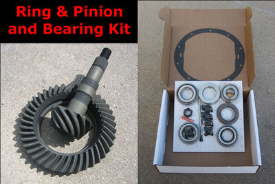

I'm currently running 32 inch tires on the stock 3:73 gears, between the up hill power loss and bad gas mileage, I'm thinking its time to make the switch to 4:56 gears. Has anyone done this in a truck the same as mine, and where would be a good place to source the gear sets?
Cheapest I found a while back...
Mine are Yukon Brand. I don't remember where I bought them from.
When it comes to an aftermarket ratio, just plan to buy new. Jeff's Bronco Graveyard is my go to for all things differential.
