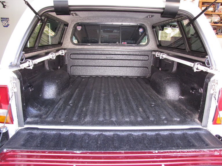

Starting Point
Here is the starting point.
I used to carry the spare tire in the bed, and it took up a lot of space. I also removed my Hi-Lift mounts and shovel mount.

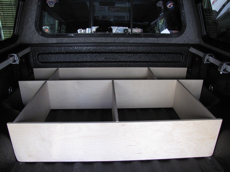

The Plan

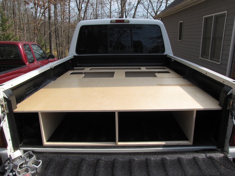

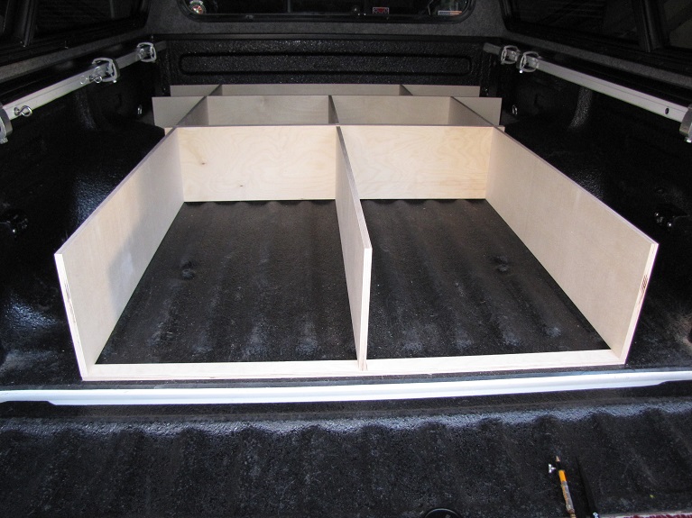

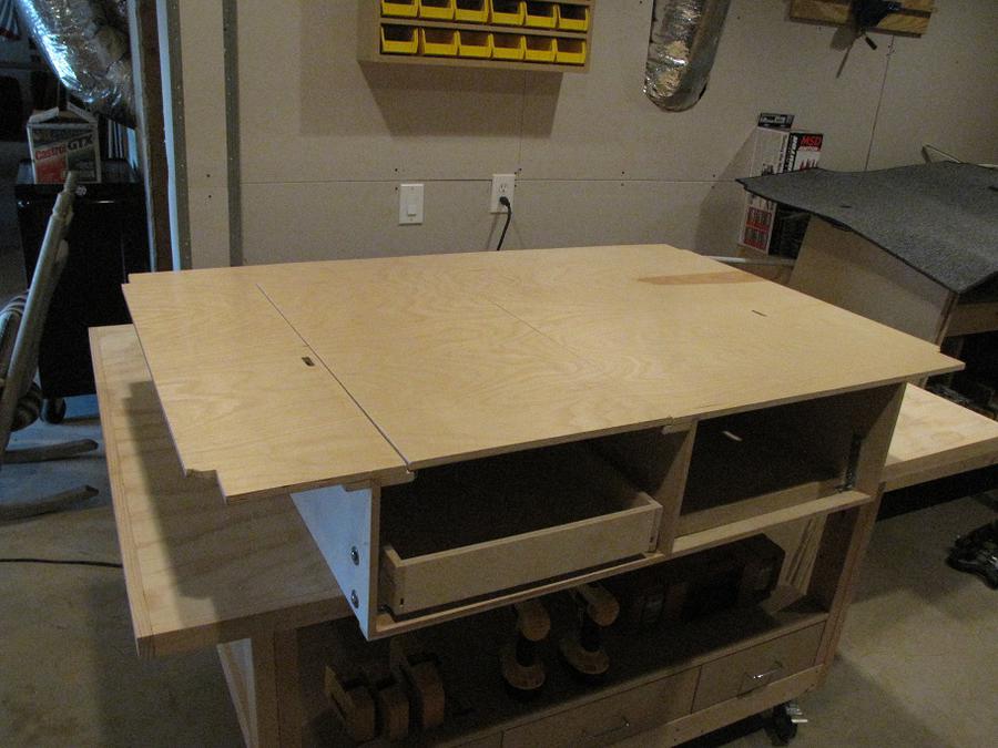

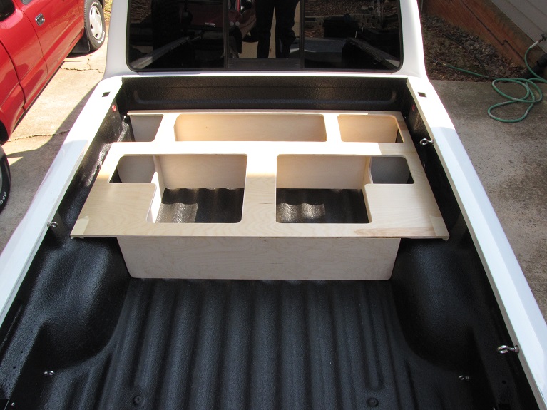

For building materials, I decided to use 1/2" plywood. I found some cabinet grade wood, varnished on one side. I cut 1/8" deep dados, and used glue to hold it all together.
I decided to build the platform in 2 sections. Since it was going over the top of the wheelwells, I could build it wider than 4'. Seeing as plywood sheets are only 4' wide, I had to turn them to get the needed length.
The forward section would contain storage compartments, including a compartment for a second battery.
With a general idea in mind, I went to work. Most of the dimensions were determined in place.
  • Scott B.'s Sleeping Platform Build
The second section would be accessible from the tailgate - no need for small compartments.

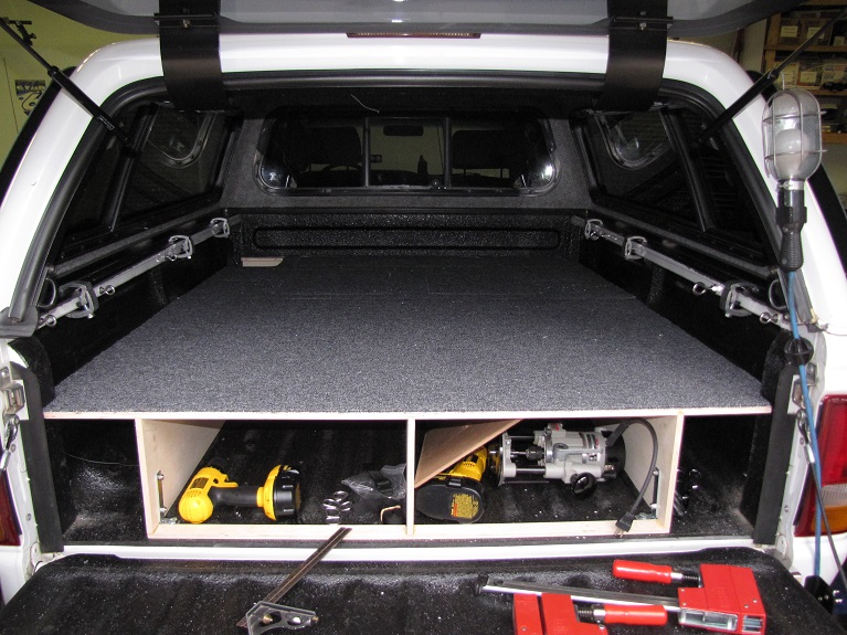

Installation
Since the sleeping platform is so wide, I had to remove the shell to install it.
Here you can see the forward section installed, the rear section installed, and the carpet cut (but not trimmed).

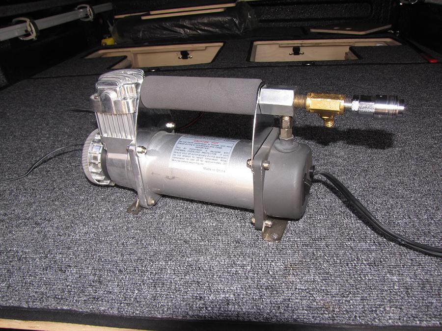

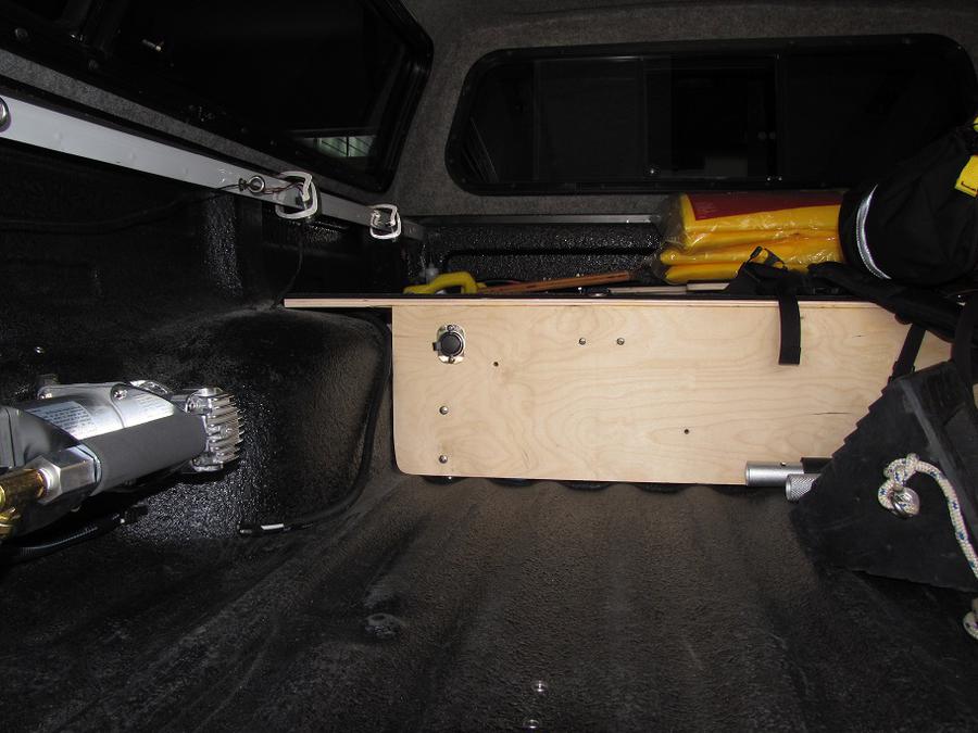

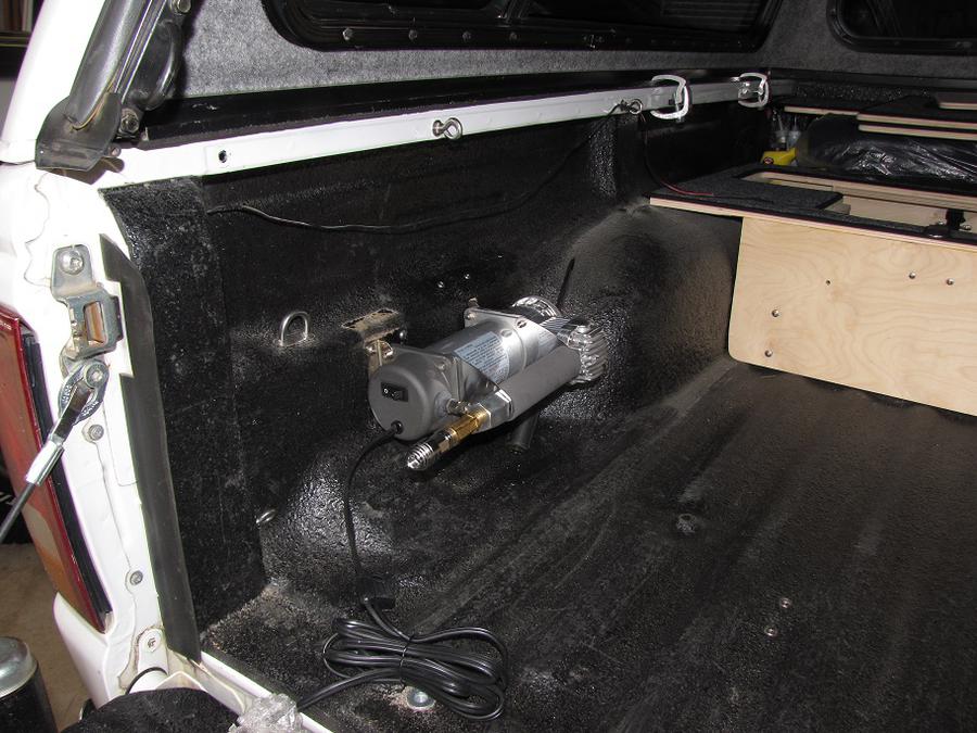

I mounted a Viair air compressor under a corner of the platform. I also mounted an air tank under the bed - link

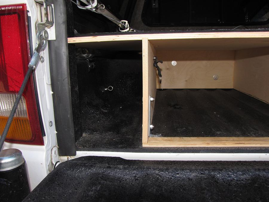

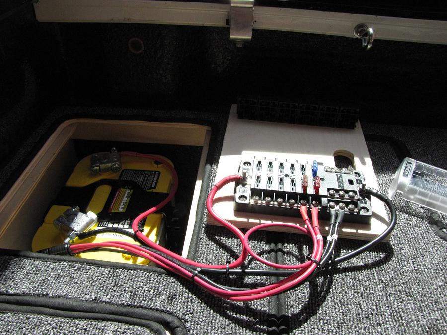

I installed a 2nd battery in the front right compartment. I put it on the right side for counterbalance weight, and forward to keep the charging wire as short as possible.
I put a Blue Sea Systems 12 point fuse block on a removable mount. There is room for 6 relays also.
Here, you an also see the bias tape edging I put on the carpet.

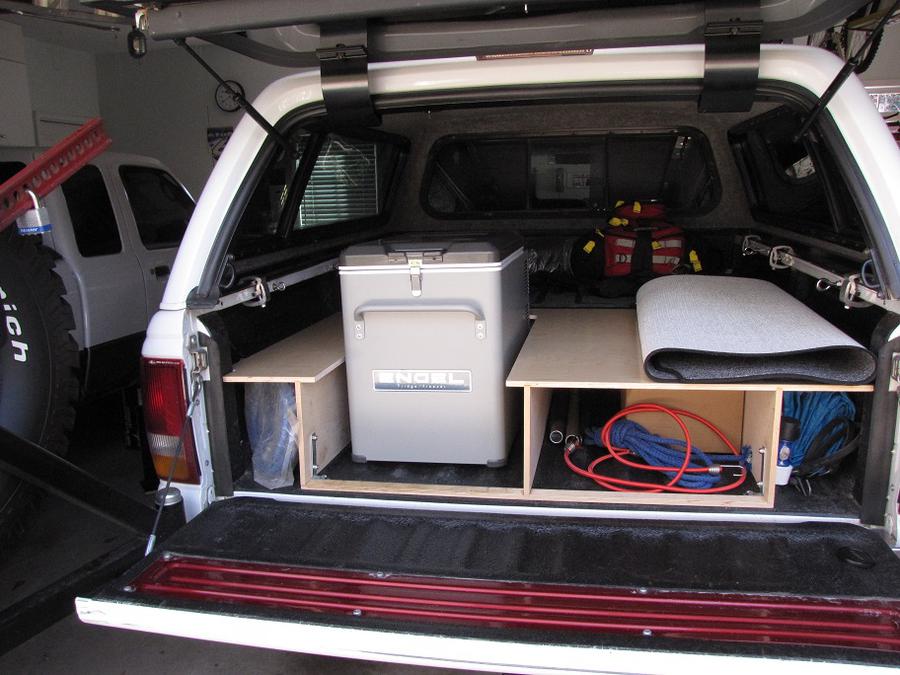

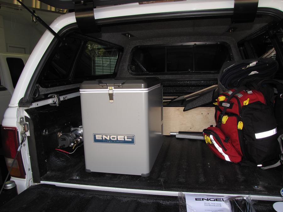

Next up is the refrigerator. For the longest time, I though a frig was a waste of money. I have changed my mind. It is expensive, but the convenience factor is huge. Really huge.
No ice to buy, no soggy food, no ice water with who knows what mixed in it. No having to hit town after a few days camping/exploring.
It's even great to have when you go out for the day. All in all, expensive but worth it.
The only negative is the size and how much room it takes up in the bed.
Here, you can see the process I went through to mount it.
First, where to locate it.

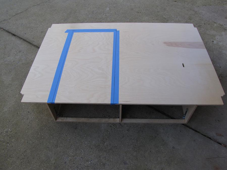

Mark and cut the platform.
Run power from the second battery.

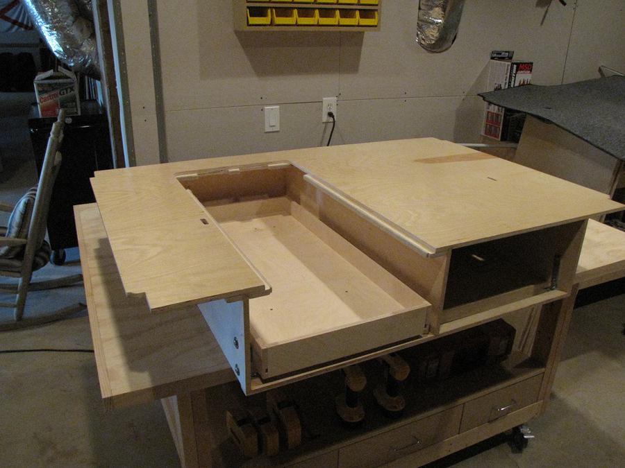

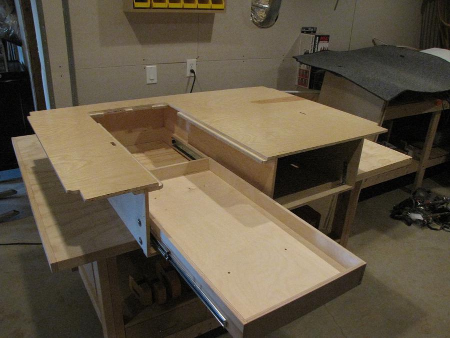

Another test fit.
I built a sliding tray to mount the frig.
