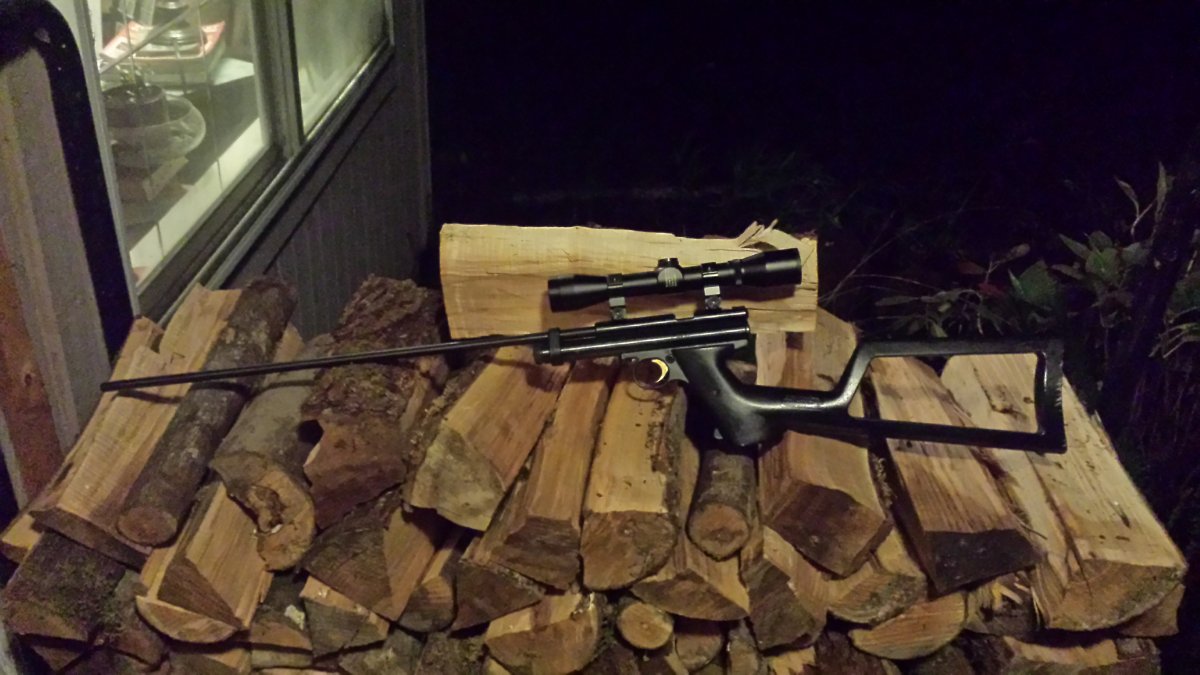

One of the reasons I like Crosman is parts availability and most of their guns are considered "lego guns" like the 1377 or 1322 pump pistols and the 2240 CO2 pistols (and it's various factory builds like the 2300T and whatnot), for example the builds in the next couple pictures... the one with the scope is a 2240 with a I think 24" .177 barrel, stock valve, steel breech and the Crosman offered butt stock (I have the part number to get it through parts at like half price...). The second pic is a Crosman 2289 (same as a 1322 but different pump handle and a quick release butt stock) with a longer barrel, then another 2240 with a longer than stock barrel... that 2240 with the long .177 barrel gets like 60 shots per CO2 cart and is quiet, I've taken many starlings with it...
