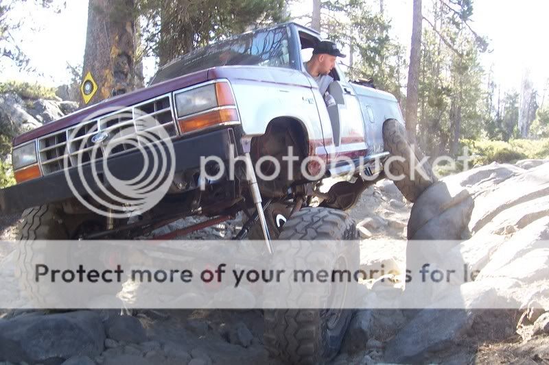

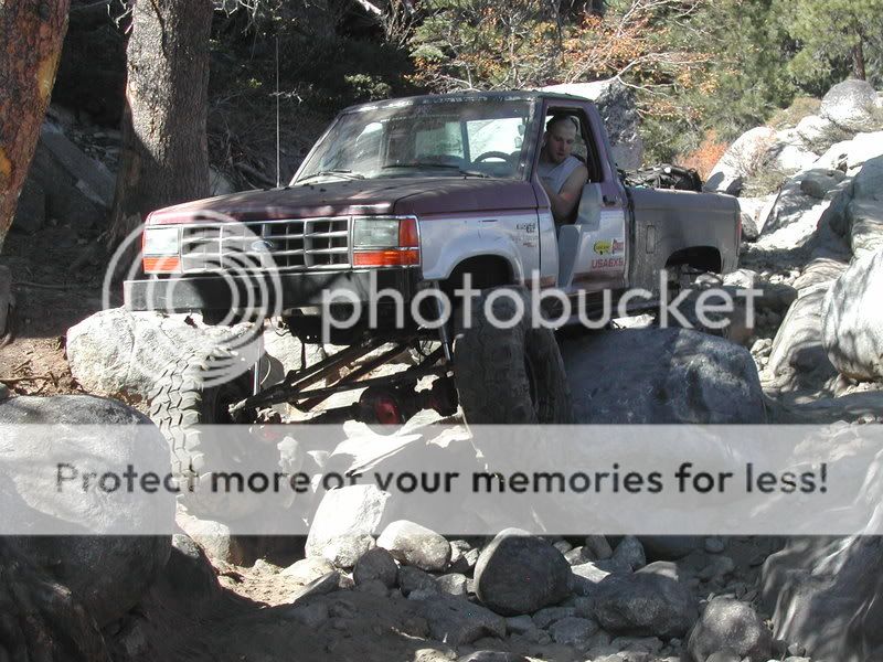

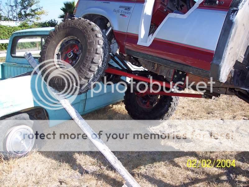

SAS pics please
actually i have yet to break a joint (been using the 760's) i keep snapping them at the neck down. But i am saving my pennies for moly's
does anyone have to give it more pedal in 4wd (when takin off). Like it bogs down bad? Is that normal? or do i just not have axle fluid up front...lol

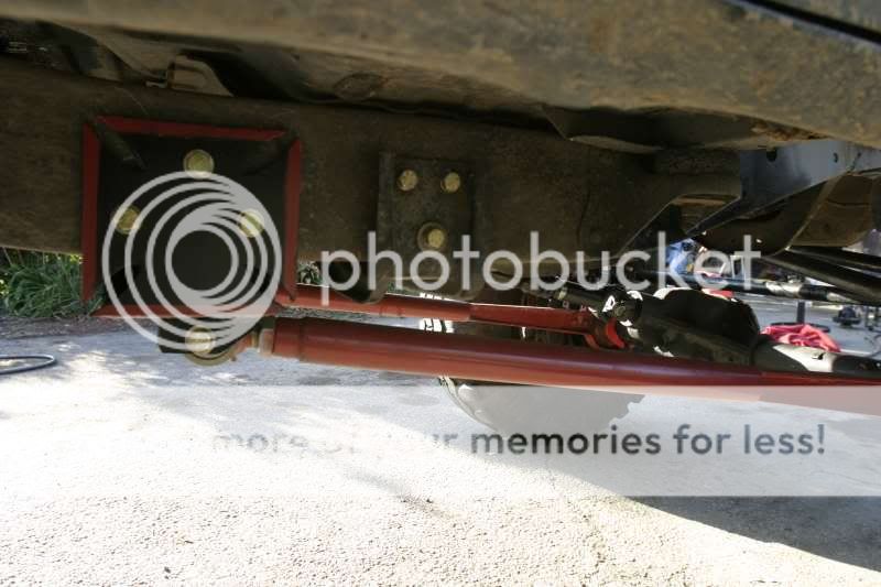

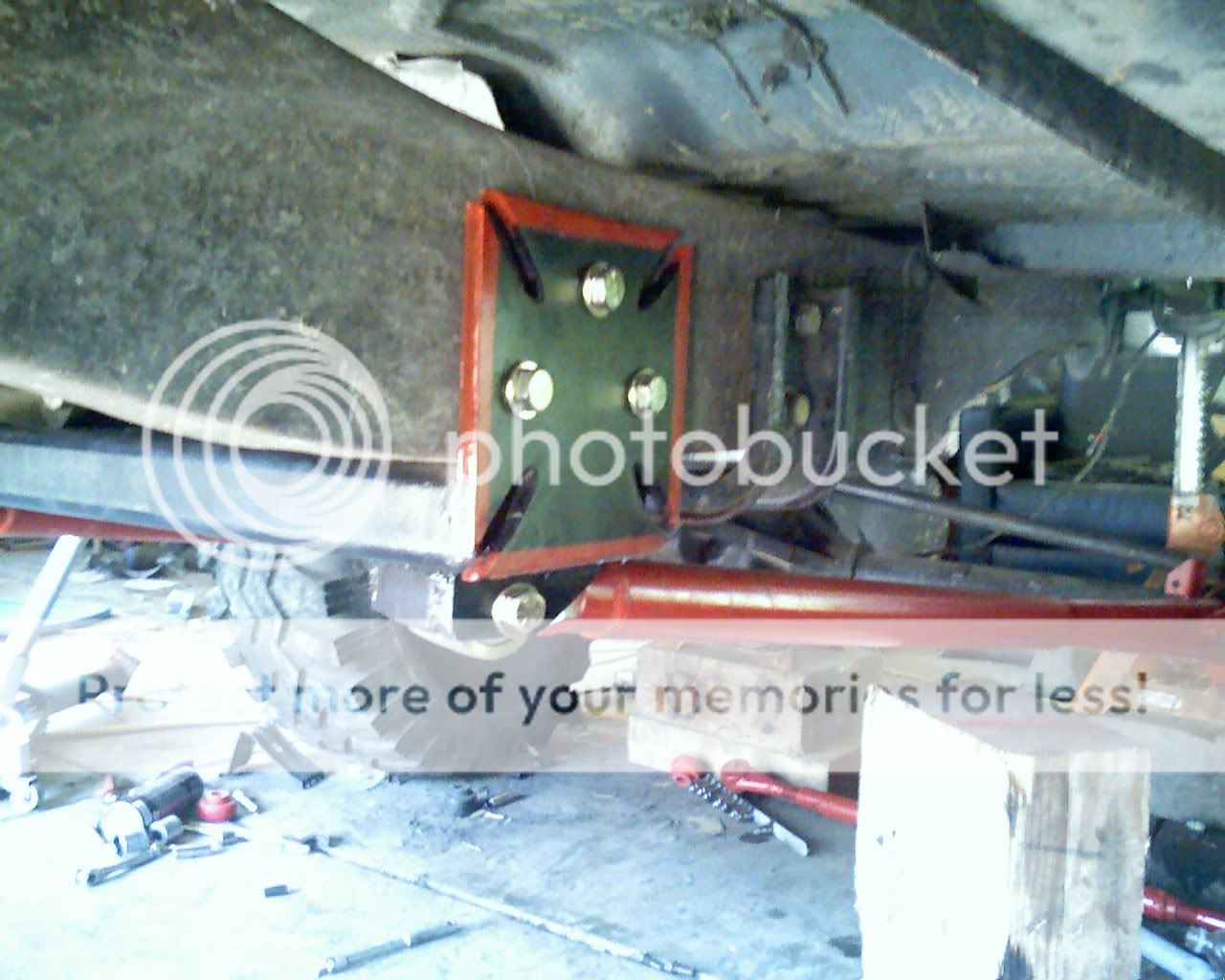

look at my build for more pics and info in the show off thing
:icon_thumby:i like your setup for the radius arm mounts look cool
