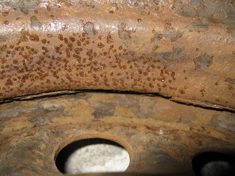

Hey folks,
I've got a leak in my '98 B2500 stock steel rim. Spoke with a welder about fixing it but the leak is too deep in the rim to get a solid bead on. He reccomended i strip the rust off (theres a lot of it) and lay some JB Weld or fibreglass on it.
I've been using a wire wheel and a drill to strip the surface rust off the rim but I can't get to the leak spot. In the area of the leak the rust is coming off in strips, almost like shale.
I've picked up a cheap sandblasting gun and some media to hook up to my air compressor. What do I need for a setup? I know this stuff can cause damage...
Thanks
If it's a stock steel rim, I'd just look for another set. Junkyards around here run less than $20 a rim. And that one sounds pretty far gone to bother saving. Plenty of newer cheap steel rims on OEM's as well. Shoot, I think a set of NEW steel wagons 15" with a 5x4.5 pattern are $45-$50.
^ im with captain ledd on this one, if its that far gone just get another one - new Cragar soft 8s were $45 each so im sure the JY will have some stock wheels for cheap or possibly even another member in your area where ever that is?
i have to agree on getting newer rims. hell if you were close I'd give you a set..
Can anyone answer the question?
What do I need to sandblast?
*sigh* Fair enough. But one last warning that you are wasting your time, money, and jeopardizing your and everyone else around your-selfs' safety.
Your rims are rusted to the point they have holes in them.
Even IF you successfully manage to weld the leaky spot, what are you welding it to? more paper thin metal waiting to break? Welds are only as strong as the metal surrounding it.
This is not just about you saving a few pennies, or "at least I'll end up with a sandblasting rig afterwards". No, you are not just betting with your own safety you're messing with the poor person driving next to you, or in the on-comming lane. Because your rim is rusted to where it can break off if given a good enough bump.
There is no fix for this rim.
IT IS DANGEROUS.
Buy another one.

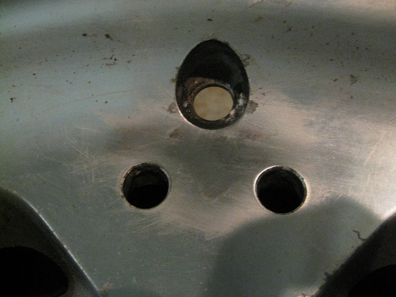

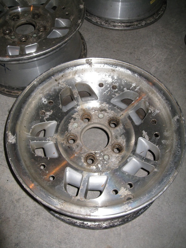

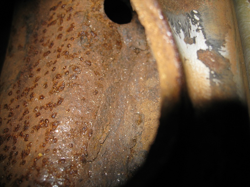

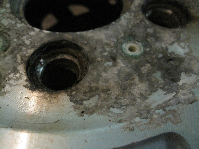

Got Pics!
First two are the steelie - Not the chunks of rust.
The ones after are the new alloy I got off of a '94. Needs a lot of cleaning :bawling:
