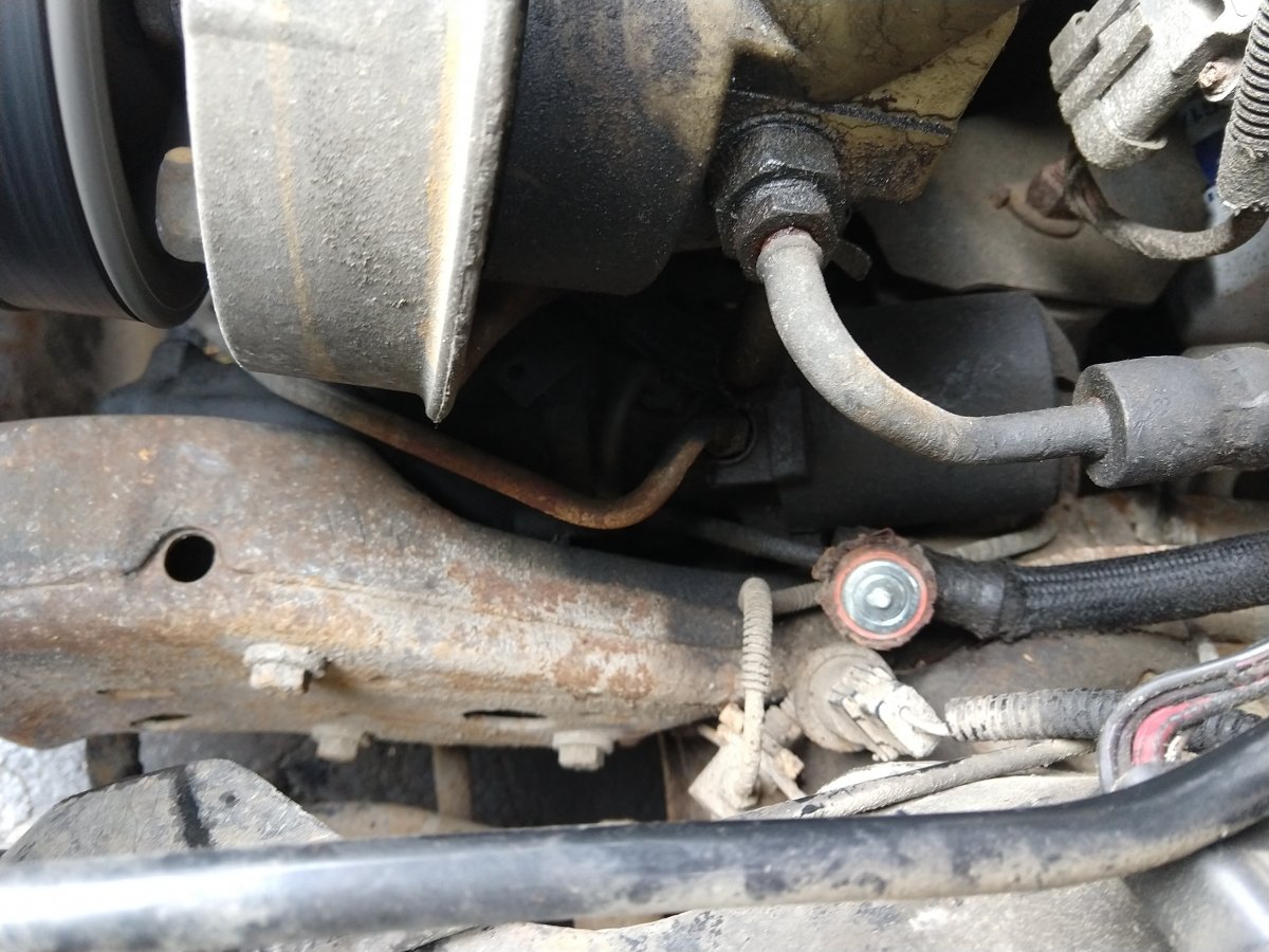

The metal top of my 1992 Ranger XLT 2wd manual trans power steering pressure switch broke off. No fluid is leaking. The top part, connected to the wiring, has a metal bar inside that appears to make contact with a pin in the bottom half of the sensor. No fluid is leaking out of the bottom of the sensor. Is this safe to drive while I order a new pressure sensor? Looks like tight quarters for the installation. Bloody knuckle time, for sure. Safe to drive before I replace the switch? I feel no difference in the power steering boost at high, medium and low RPM. I noticed it only today when I had the hood up. It might have corroded away and broken off a long time ago for all I know.

Totally fine to drive it as is. IIRC its function was to increase engine RPM at idle in certain situations.
+1` ^^^
No issue at all
Used to prevent engine stalls at idle when using power steering, i.e. in a parking lot, will bump up the idle RPMs if pressure gets too high
It will set a code if not working or disconnected, but code will self clear when its working again
