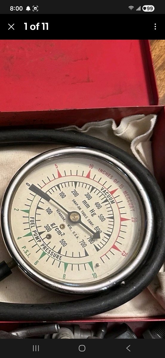

Ensure your electric fuel pump isnt providing too much pressure. Only need 4 to 8 lbs.
Set the base timing. 10° to 12°, then get a vacuum guage and set the idle mix screws to achieve the highest vacuum. Use the idle set screw to get the correct RPM. Then let us know how its running.

Hey this is awesome info! I assume I need some kind of gauge to measure fuel pressure? Or can I tell from the float bowl? For the idle mix, I maximized RPM which should in theory maximize vacuum as well right? I did set idle speed to spec after doing that.

Buy yourself a fuel pressure and vacuum gauge. Iirc at that low fuel pressure they will be combined into one unit.
