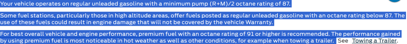

So, in a burst of energy, and totally against my normal operating procedure.. I went and pulled up the online manual!
and found
paraphrase - is designed for 87 but if you want the best mileage and power higher octane 91-93 is suggested.
I will try and find it again and paste it here. But it is in the manual lol
thanks !
Found it lol
