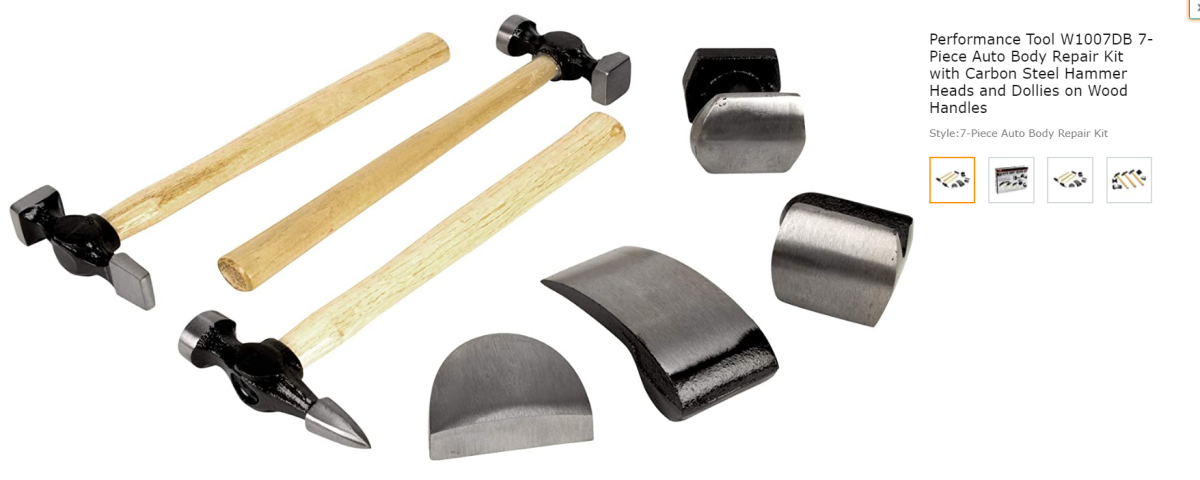

Go to your local Harbor Freight and get a body tool kit like this... 7 or 9 piece kit

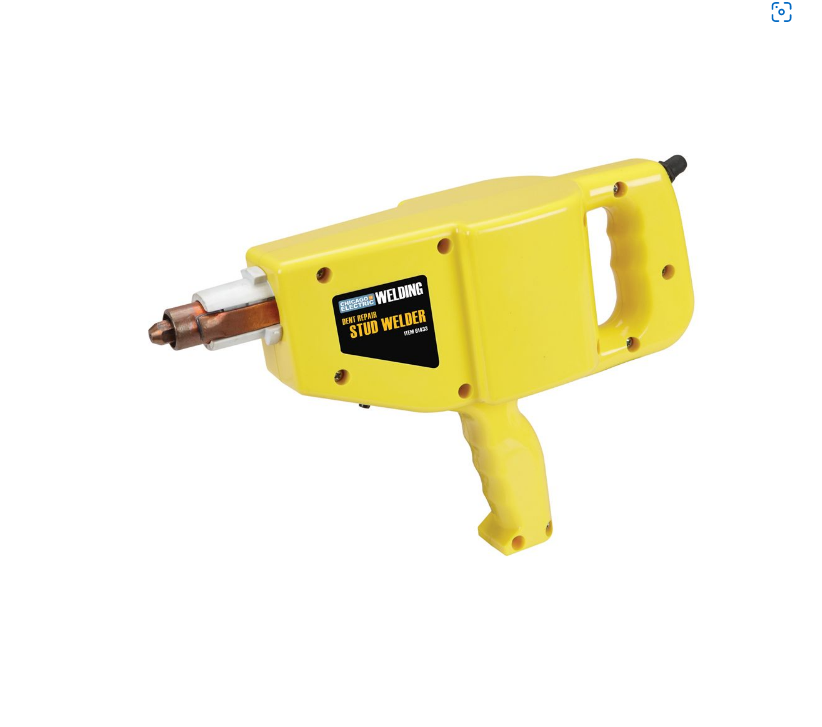

a stud gun like this... don't install a bunch of studs right next to each other, the heat from the gun will warp the metal, spread them out around 4" apart.
