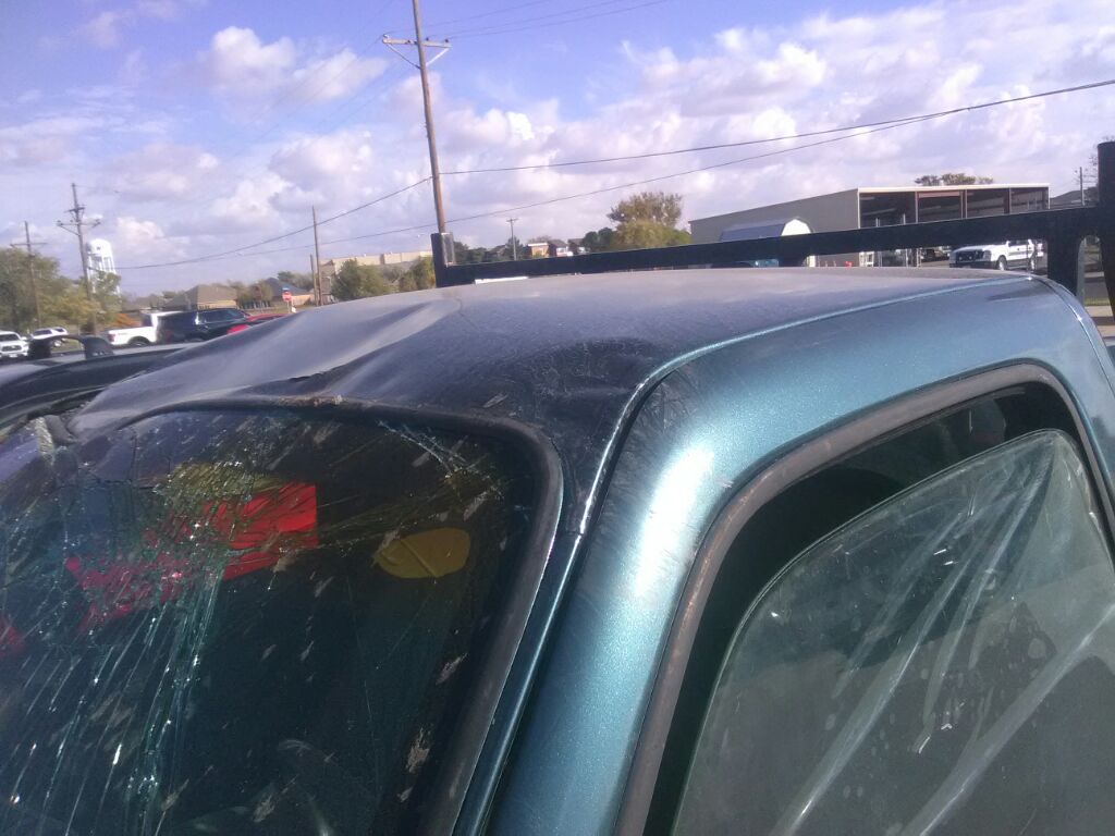

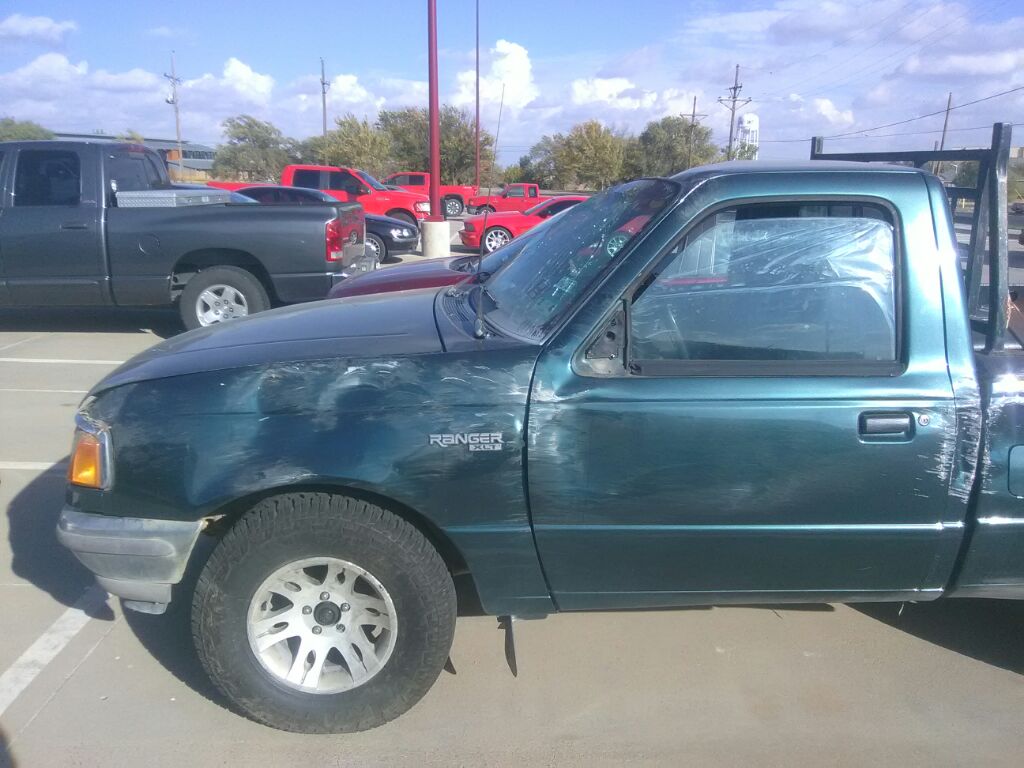

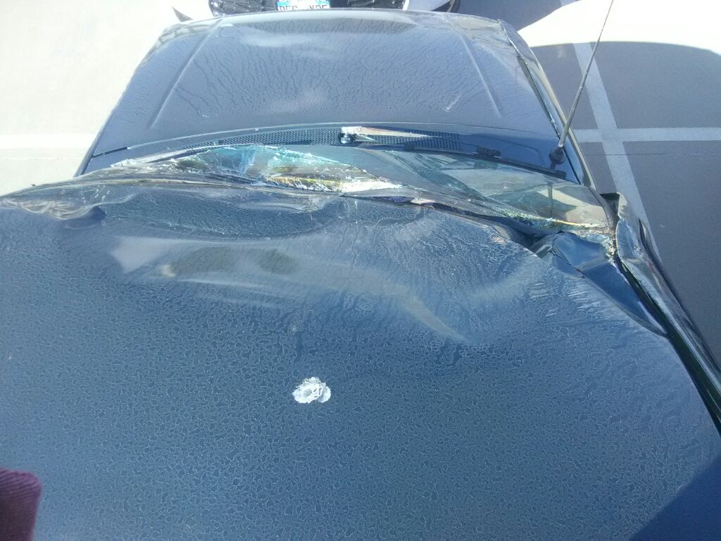

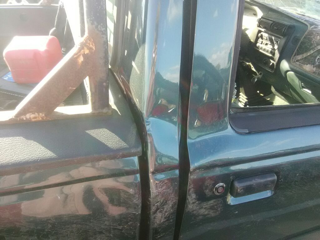

Upon further inspection all the body damage starts about 3-4 inches below the top of the bed. with only more minor cab damage below that line.
A body swap alternative that came to mind is to buy another cab and cut them both in half only keeping the upper half of the new cab. (roof swap) This has the benefit of less wiring and connectors to deal with but the downside of keeping my crud interior.
I am no body guy or welder but is this more feasible to have someone do than a true body swap?
Update 2: attached files.

Post a couple pics.
It might be able to be beat back into shape enough to get a windsheild in it....or is the cab still straight just the windsheild is smashed?
Passenger side window? Assuming the door aint tweaked 50 bucks from a boneyard...same as mirrors.
Post a few pics...maybe its saveable as is....
As for the dating thing...if shes turned off by a beat up truck she aint worth your time anyways.
Post a couple pics.
