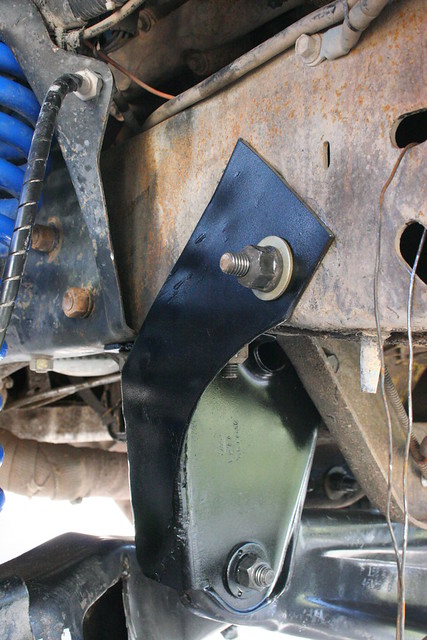

I'm assuming you bent the right side drop bracket which holds the left side axle.
Here is what I did to reinforce our drop bracket to it wouldn't get bent when wheeling (have a cut/turned beam on it so I'm using the stock brackets).
Modified stock axle pivot by maniak_az, on Flickr
