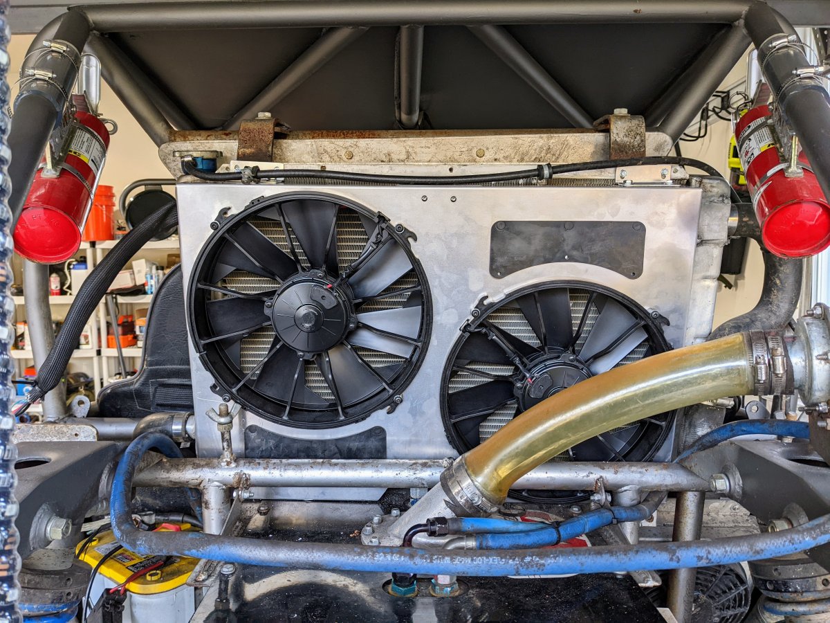

Got one of these to replace my dead spal fans:
Got the fan wired in today, and it turns off and turns on, so now I need to give it more if an extended test and see how it goes. It comes on a little later than I'd like but the process of changing it looks like a huge pain.
