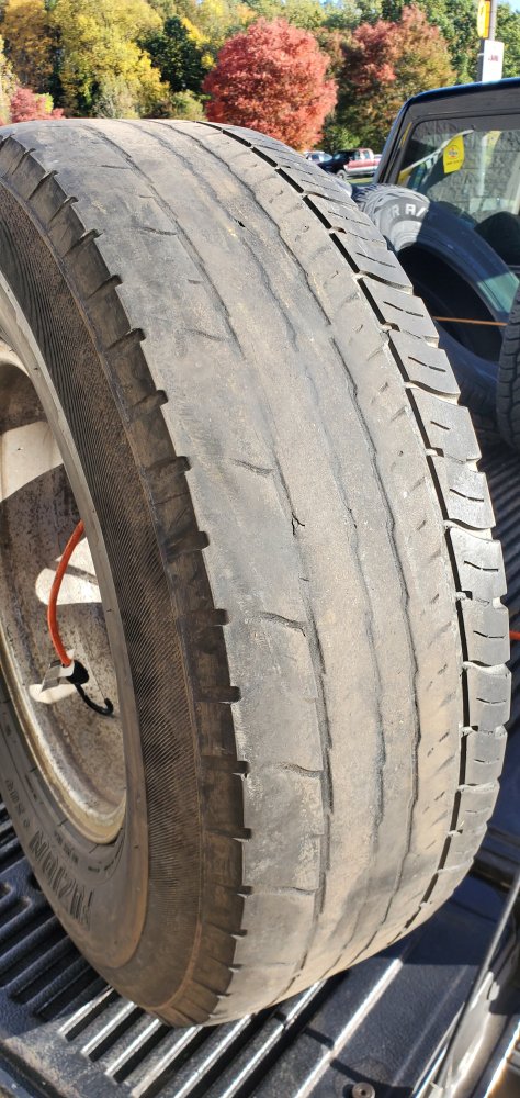

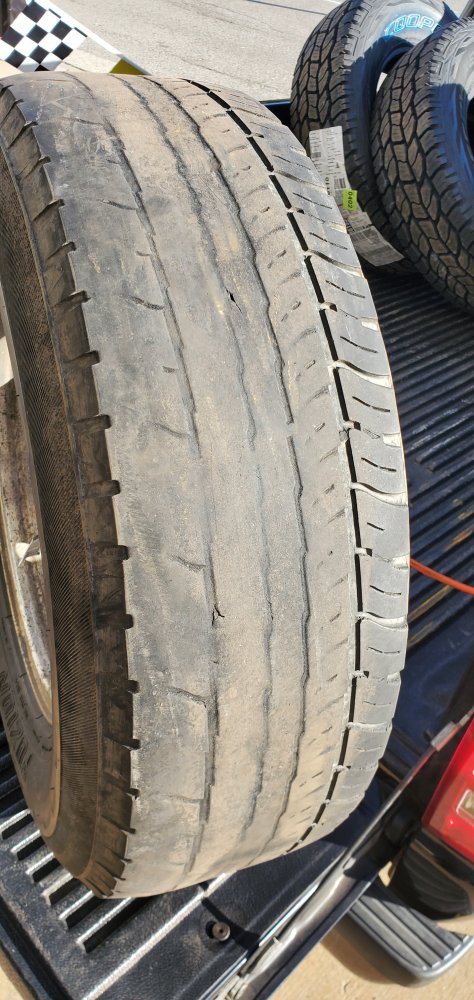

Rear tires post-locker.
I see what the problem was now, you were using chinese tires from 1973...
Call it what you will, I simply do not believe Tom Hanks should be allowed to sell spaghetti at the post office.
wow, looks like you were doing burnouts or figure 8’s with a full spool.

That tire wear is indicative of a bent rear axle housing (tires more worn on the insides). Not saying the locker didn't accelerate the wear (it does to some extent), but I think yours is a combination of issues.
