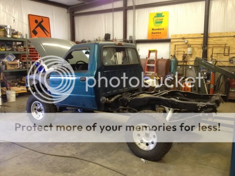

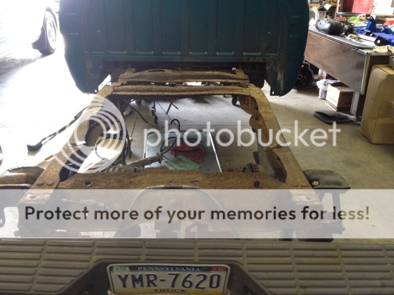

Here are a few photos from mine. Take a look through my build thread for more details. :icon_thumby:
Monstaliner:
Chassis Saver:
