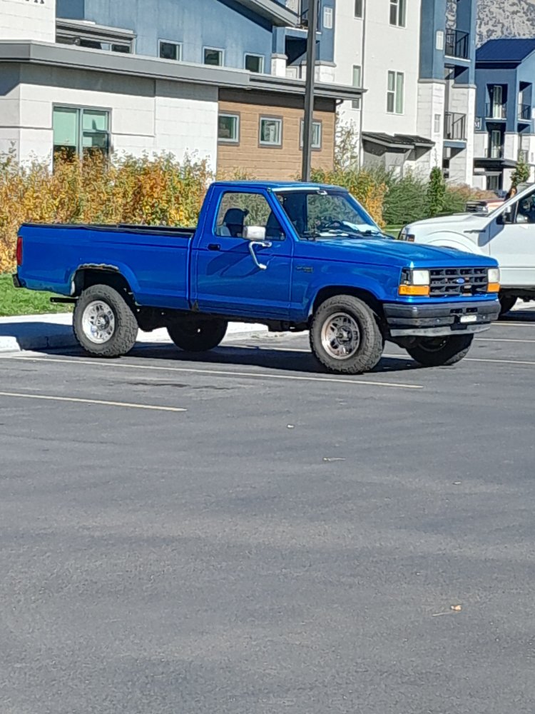

I am currently in trade school for automotive service and have some autobody experience. I want it mostly as a daily but capable of getting places off road. Already read build guide but felt that it wasn't very detailed. What would be the process in tearing this thing down and basically rebuilding the truck. I want every component to look just as it looked in 92. Any help as to what to replace vs. rebuild?

That's a really nice looking truck as-is.
I can understand how attractive the thought of a "zero time" vehicle is. That being said, a truck can only be original once. At 32 years old, and still looking that nice, it's really more of a "survivor" than anything else. Granted, one picture doesn't say how well it is mechanically (engine, driveline, suspension and steering) nor how well the interior has held up.
So another approach on the truck, would be a "replace or repair as needed" and keep as much of the originality as you can. A careful, professional repaint and body work where needed, and just replacing the missing, broken or worn parts would make that one an uncommonly outstanding truck, I sincerely believe.
Strictly period correct wheels would be a judgement call; the deer prints are nice wheels, but they came out a year later with the revised '93 models.

Wherever you can find them. Check often on eBay, google "1992 Ford Ranger wheels for sale", junk yards, swap meets.
Parts in general are getting hard to find for these older trucks; NOS Ford parts can be pricey as hell, when and if you can find them.
Also I would verify some of the specs you listed, in '92 it should have a Dana 35 up front, 10 bolts holding the front diff to the beam is the easy telltale, unless it's the hybrid then it gets more complicated...
'92 being the last year of the 2.9 does leave it a possibility of not having an M5OD but it would probably be worth double checking, door code would be M for M5OD, don't remember what the others are.

That is a nice looking truck you have. You would be surprised at what you can do with what I call a "Rolling Retoration" and is what I like doing best. I have done full frame off restores but that takes a lot of space and time. As long as you are staying with it in stock condition, most things can be done on a weekend. Remove the bed and you can get the whole frame, fuel tank, and rear rend. Engine detailing and engine work can happen on a weekend.
