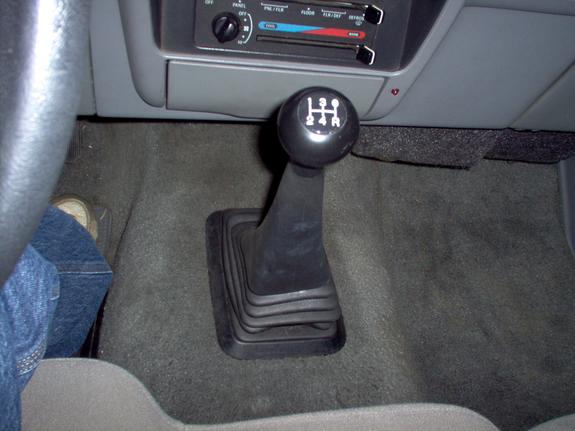

My 5r with my shift kit can shift faster than you with your m5od on your best day times ten.... your foot cant beat a computer.
Darn. How fast do I need to shift? :unsure:
I think I could give a stock 5r a run for the money. But put a shift kit in there and nope. And an auto never misses a shift.
I don't think I've lost a 200' sand drag in my class unless I've missed a shift. Everyone else runs auto. Of course there's a lot more than shifting involved in winning a race.
