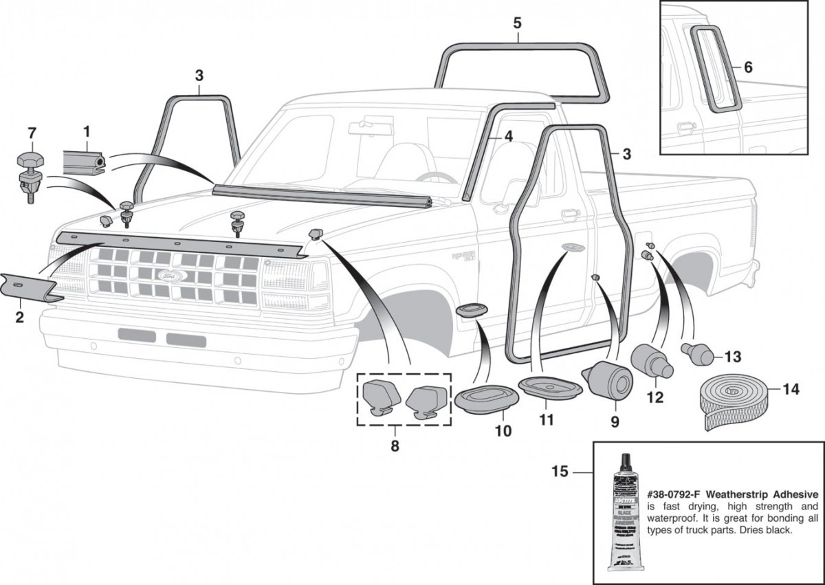

what is the rubber seal around the door opening on the cab side (cab mounted but seals door) called? no matter the search I only get the stuff mounted on the door??
If you know, Thanks
Keith
@ChefKeith Look at the LMC Truck's website; I copied their catalog picture below. There's two pieces on the cab. Item #3 LMC calls "Weatherstrip on cab"; Ford calls it "Front Door Opening Weatherstrip". The second piece over the door, item #4, LMC calls it "Upper door weatherstrip", and Ford calls it "Roof Side Rail Weatherstrip". Looks like you can buy them from LMC, but with the differing terminology maybe you can google up some other sources, too. Good luck!

I downloaded that catalog also.... but I can't jump to a specific page, I have to scroll to get there? Am I missing something?
KP
and that's important ? why?> there is NO mention of rear hatch in that catalog
