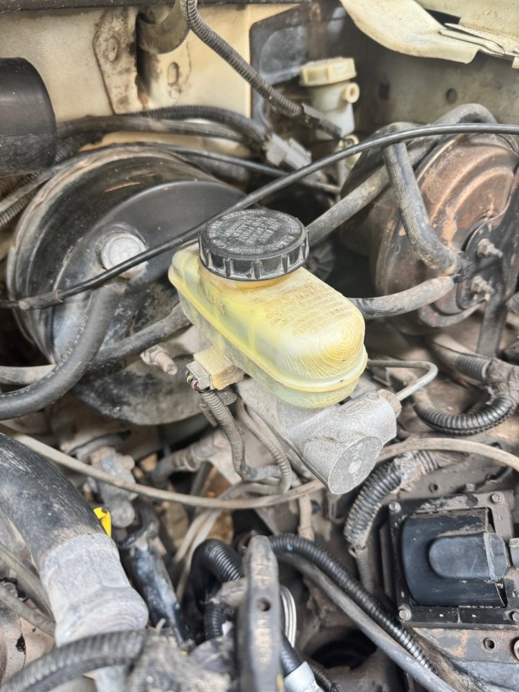

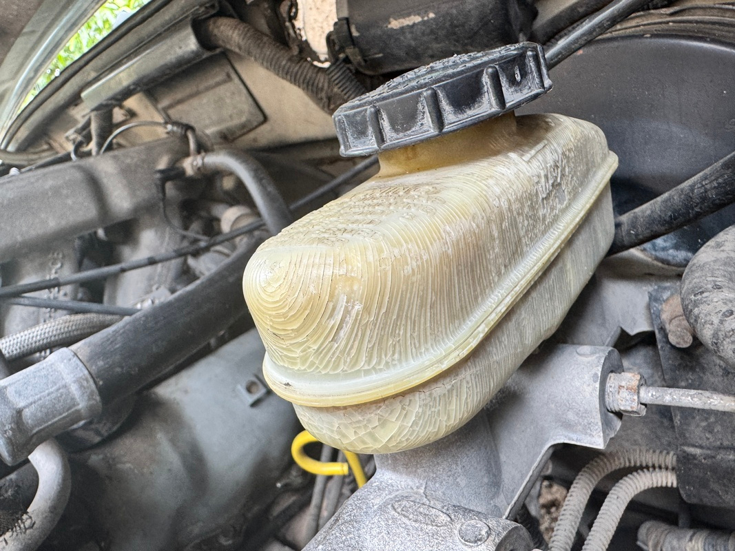

As you can see from the pic, my master has seen better days.
Doesn't help that I whacked it with a ratchet by mistake.

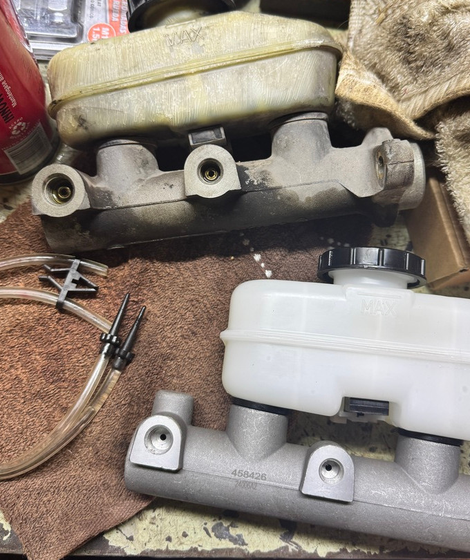

I could replace with another bronco unit, but was wondering if one out of an explorer would be better.
Since they cost about the same...
I looked at the one on Rock Auto. Seems to be a slight difference in the shape. So, I don't know.
Disc brakes require more fluid so you don't want a disc master with your rear drums, it would likely make the rear brakes want to lock.
I recently replaced my Bronco II's master cylinder and just got one of the generic ones that Autozone has in stock. Works great, inexpensive and has the electrical connector.
Ended up getting an 86 Explorer master (without the extra sensor port).

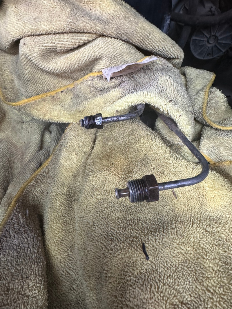

Now I need adapters, or re-flare the existing lines to play nice with the newer master.

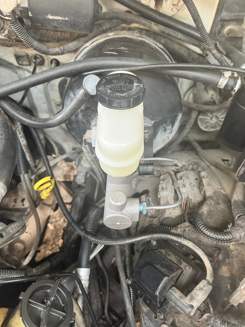

After some practicing on how to make iso/bubble flares, we have now have the replacement master-cylinder installed.
No leaks :)

Original flares:

All that's left is to bleed the brakes :)
