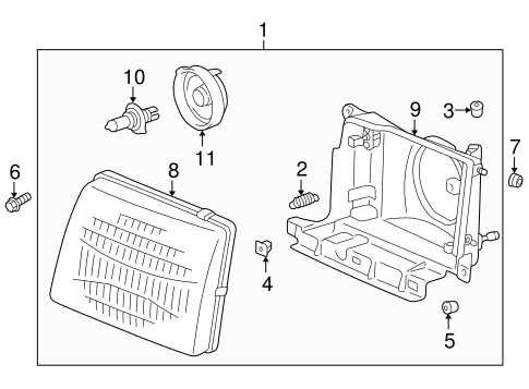

In this pic I think what I am replacing is part #8 I don't see why I'd need to replace anything else, I don't see it broken or anything. Just the lens is really yellow and cloudy and makes it look old plus I'm probably losing a bit of headlight strength on the road. Frankly I can live fine without replacing them I just thought it would look quite a bit better so I guess that's just vanity.

Te item you have noted from Rock includes everything you need to replace your current headlamp(s).
Adjusting is really not that difficult. Level surface 10 to 20 feet from a wall or garage door. Turn the adjusting wheels until they are level. If they are too high, oncoming traffic will let you know pretty quickly.

In my experience with several vehicles with composite headlamps, the plastic lens will get fine cracks over time and then moisture will get into the headlamp assembly. The lens is glued to the assembly and isn't available separately because the glue is supposed to make the assembly weathertight (until the lens cracks, that is).
I bought a set of aftermarket headlamps from eBay last year to replace my originals because of the fine cracks, even though the lenses hadn't yellowed. The dealer I bought the truck from might have polished the lenses to remove yellowing, don't know. Aiming the assemblies wasn't any big deal, except that I would have to remove them from the truck to tweak the bottom screw because I didn't have a tool that would reach it in that confined area. Then I would reinstall it and check the aim.

So all I need is the lens unit.
