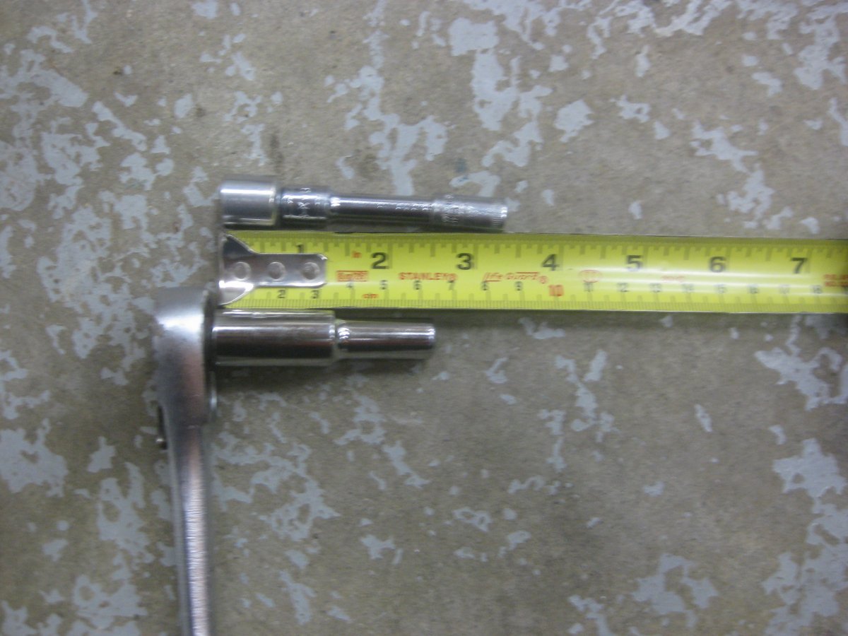

I think a small (1/4" drive) ratchet drive would be maybe good for this. Here's the lengths that worked for me for a 3/8" drive, a 1/4" drive might work better in terms of being able to turn it more 'clicks', it takes a long time to get them in/out. That is really the hardest part of the whole thing is finding the right tool to fit in there straight onto the bolts.

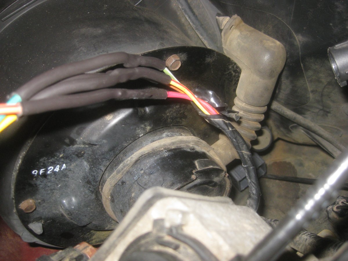

Here's the wires soldered and shrink wrapped, but before fully wrapped:
66122
Then I wrap them all the way up to the connector, as described earlier. Don't forget to test it before putting it all back together. The new parts you will be able to get the connector on and off rather easily, unlike the old one. Leaving the connector off while re-installing the resistors makes it somewhat easier to get to the bolts.

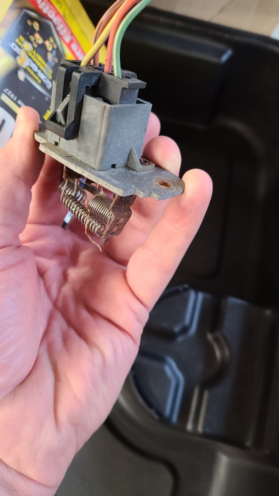

I think I could have tried to get the resistor out without taking out the air intake and the double reservoir... and in the video there was a cruise control unit the guy took out too.... The only reason for removing it all was to get a straight shot at the two 8 mm screws.... Like I said, there was ZERO chance at getting the plug out of the resistor assembly.... so out came the entire thing. drew a diagram of the wiring to make sure it was put back right....
I will attach a picture of the old resistor... and laugh if you want to.. but I tried to get the plug out using a vise and hammer and slip pliers... literally everything and it still will not budge....
When I tested the switch before I started this, it worked only on the highest setting.... but at least it worked... Now there is a difference in the speeds and all the speeds do work... I can live with it the way it is now... I wish I had taken some more time in finishing it to prevent future rust out but the way I figure it, this unit worked for 18 years.... and 18 years from now I am sure I won't be using this truck!!!
