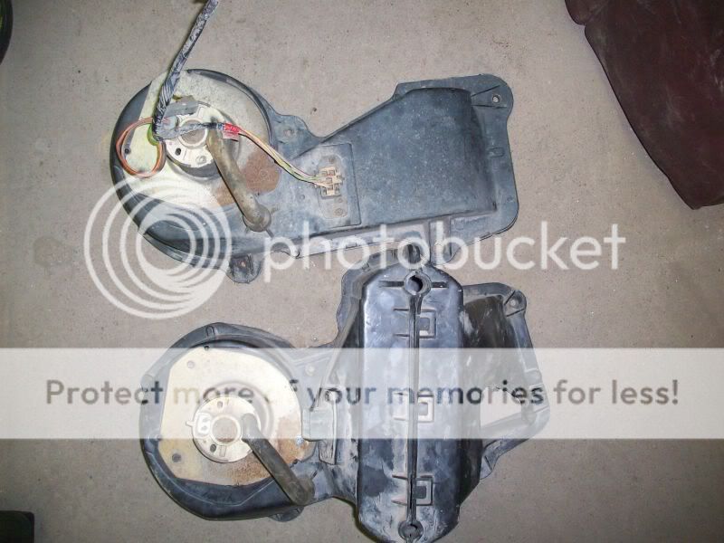

Here is mine, I melted a hole the panel you are talking about trying to get it to fit with my tall valve covered 302. You can see the holes going clear around the panel though.
Ok. Thanks.." whew"..Yeah, that looks like PITA as you state. Sometimes tho, where some of these parts are located, I wonder did the Ford engineers just design stuff just to prove how smart they were..?...:icon_welder:
