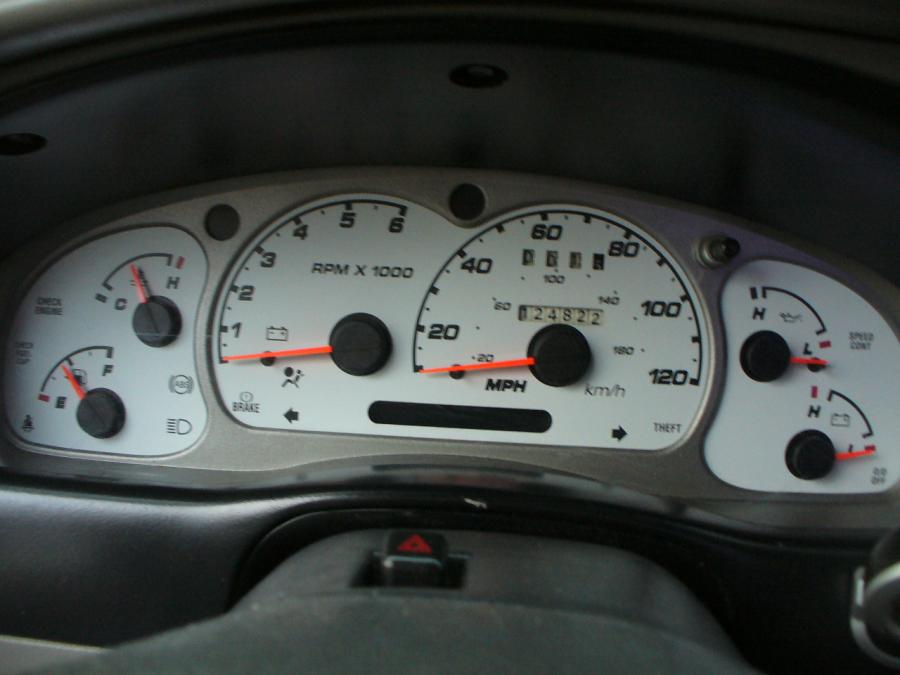

Explorer speedo work in a '96
I found a seat and a speedometer for $85. Speedometer came from 2002 Explorer. The speedometer went in easily. There were different wires, actually seemed like more wires on the 96. Instead of trying to figuring it out I just plugged it in and drove it. All lights and gauges are working fine or better than before. The speedometer is working better. There is still an error because of tires, but it is less. Love the color!
